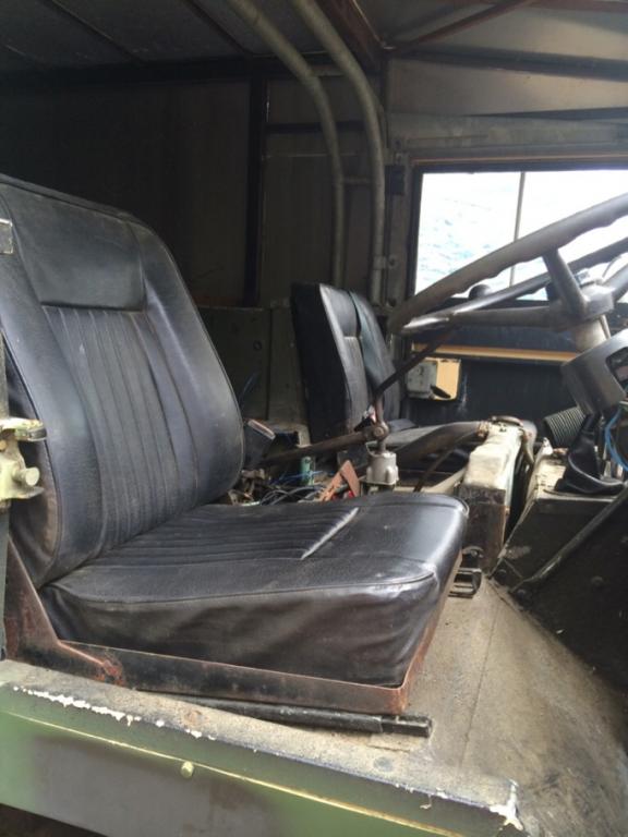

3 Attachment(s)
Got some seats in! Much more legroom now. They're not perfect, but they're better than the mice-eaten ones I had in there. And they even match!
Also, for $free.99 I couldn't argue with the pricetag.
Attachment 10123Attachment 10124Attachment 10125
