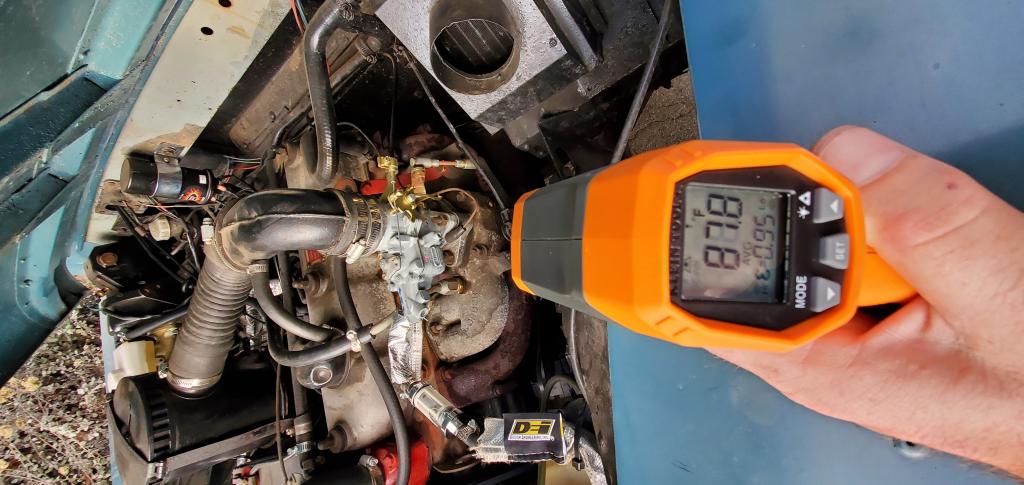

Heat profile:
First thing first, I bought a temp gun to get temp readings in places. I wanted to see where in the engine bay is hot, so I could route the fuel line away. Here are some spot temperatures after a 20 minute warm up drive on a 65 degree California Fall day:
* At fuel pump- 95-110 degrees
* At head, near water spout, right side- 134 degrees
* Top of head, near radiator line- 119 degrees
* At head, left side- 118 degrees
* At intake manifold, near head - 169.5 degrees
* At exhaust manifold, halfway to carb - 272.5 degrees
* At exhaust manifold, right at head - 360.7 degrees
* At fuel bowl on carb - 87.8 degrees
* At phenolic block on carb- 93.7 degrees
So, with the standard routing of the fuel line from the fuel pump, across the front top of the engine and into the carb…we go from about 95 degrees to a solid 120 most of the run, and we pass into the carb over the intake/exhaust manifolds that go from 360 degrees to 167 in less than 10 inches. And this is with my hood up. Likely it stays hotter with the hood down.

As I said, I wanted to try the least radical fixes first. So, I decided to route my fuel lines toward the outside of the engine bay, avoiding resting on the block. I also got some heat shielding sleeves for the fuel lines from DEI(DEI-010403) In addition, I got a small finned heat sink tube type oil cooler and put it in the front grill area, just in front of the radiator and ran the fuel line through it. So, the fuel line is shielded, and runs through 65 degree ambient temp around the outside of the engine bay and gets an additional cooling boost from the finned heat sink getting fresh air up front. As an aside, pipe fittings are a nightmare! There are a half dozen standards and good luck finding exact hardware. In my case, the oil cooler had a -6 AN fitting that needed to be reduced to -4 AN, then turned by a 90 degree bend, before outputting to 1/4” hose Barb. That was like $80 of fancy black anodized aluminum pipe hardware and 30 minutes on the phone with a tech to find all the right combos.
Did it work?
Well. Partially, but no. The Vapor Lock came back. Stalled twice. But, I noticed it cooled off very quickly at each stall. I usually had to wait 5-10 minutes to restart. Now, it was back to non-boiling temps in 30 seconds-1 minute. So, less desperate…I could restart in one light change. Whereas before, I was a scene blocking traffic for 3-4 traffic light cycles.
