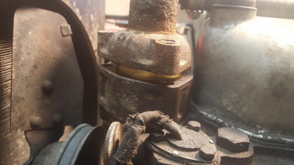

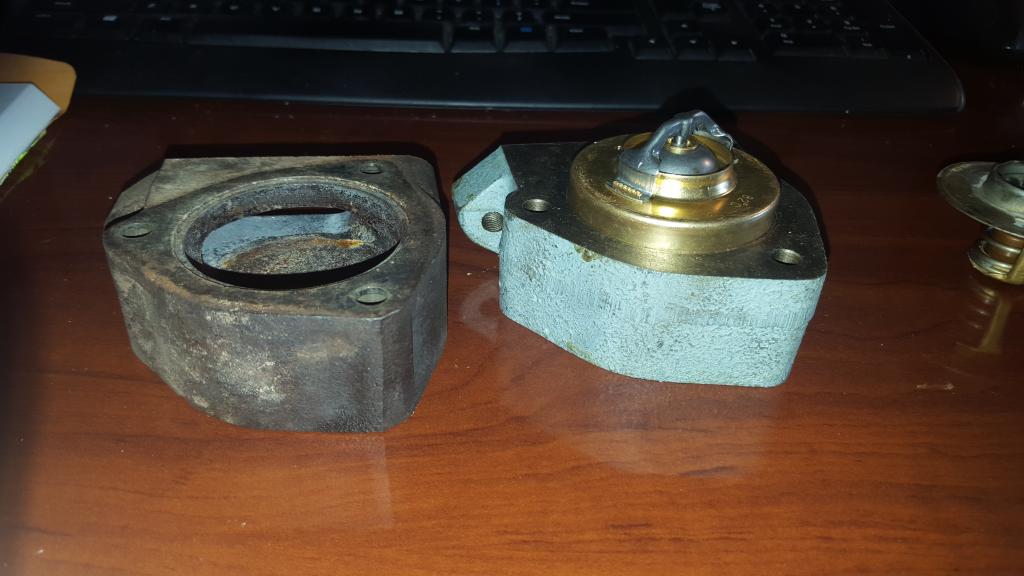

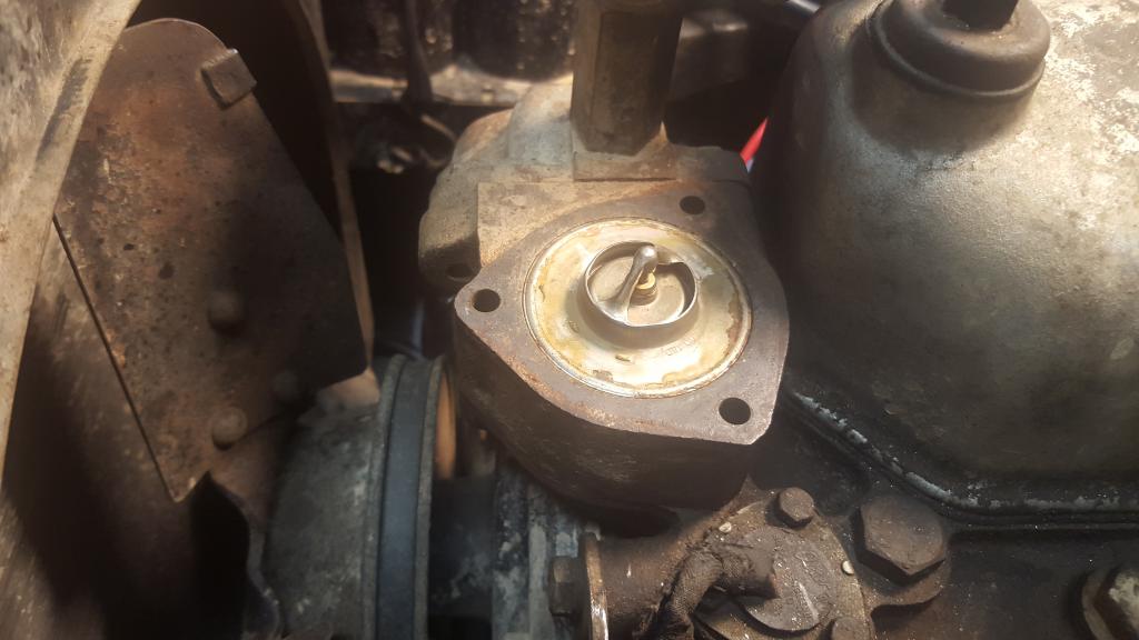

    In doing some other work to my rover, I discovered that there was a standard (non-skirted) type thermostat installed. I know that the 2.25 petrols are supposed to use the skirted thermostats. I order a skirted type and I am puzzled hast to how it is supposed to fit. Please see my pictures and let me know what I am missing here.

    New thermostat in housing:
    Click image for larger version.
    New thermostat in house with top sitting on thermostat:
    Old and new thermostat:

    Just a guess but perhaps your thermostat housing and\or cover are meant for the older bellows type thermostat?

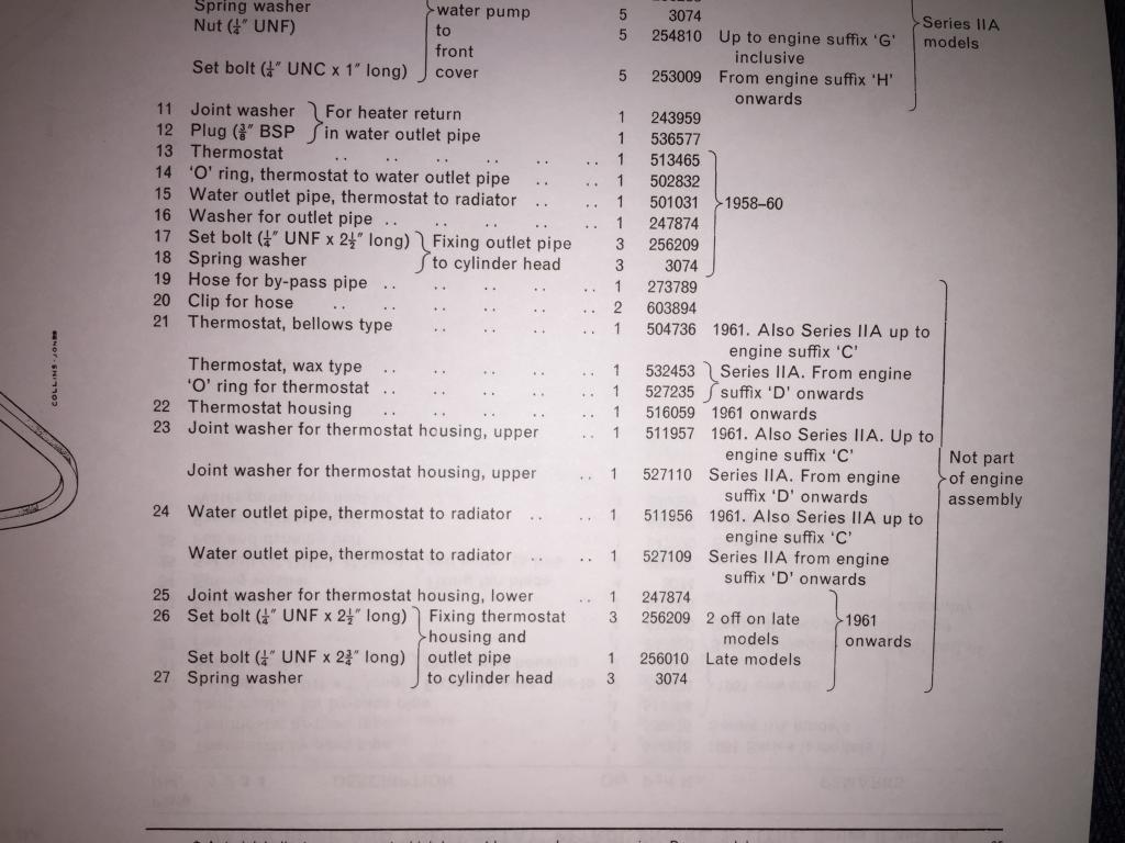

    My truck is 98 units apart from yours. I'm 24434013D. My engine is a Frankenstein as well - block and head were swapped in from a later Series 3 (engine block number is 95132560E also an 8:1) but I believe most of the parts - Thermostat housing, etc - are from the original engine. The parts manual specifies the wax type/skirted from engine suffix D onwards - see item 21 in the image below. Does your engine number end with a D or E?

    Back to my original topic. I am no closer to figuring out how to fit the skirted thermostat than I was before. I thought I needed a new lower housing, so I ordered one from our host, but it is no different and the thermostat doesn't fit down in it either (see 1st picture below). After more research, I found this blog post blog post that makes me think I need a new upper housing (aka outlet pipe): http://1960landroverrestoration.blog...d-housing.html
    (See 2nd picture below taken from the blog post, my upper housing is like the one on the right)
    But there are two problems with that, 1) a new upper housing (part 527109) is almost impossible to find and 2) I am still not sure the upper housing is the culprit here.
    Can someone please confirm for me whether the thermostat is supposed to fully fit into the lower housing or stickup into the upper housing? Does your thermostat upper housing look like the one on the right or the one on the left in picture 2 below?
    I am also starting to wonder if the thermostat I have is just not right, even though I am sure it is supposed to be an 82C land rover 2.25 thermostat.

    The deep skirt reaches up into the outlet as per left hand, with the O ring seal and according to my 1977 parts list was fitted to S2A suffix D onwards and S3 engines .The thermostat housing 516059 is common to both thermostats and the water outlet (upper) changes with the thermostat , so 527109 is the outlet for the deep thermostat. They do come up occasionally and Blanchard list it but at £99 plus carriage https://pablanchard.co.uk/Thermostat...5-litre-527109
    Your engine could be a Suffix B which often looks like an 8
