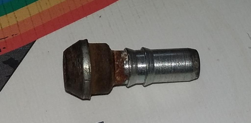

    The fuel line is made from PA11 or 12 ( Nylon) and the end could be remade . I have seen them manufacture and the plastic pipe is just warmed up and pushed over the steel end fitting. I have made many replacement pipes by warming, just the end of the tube , very gently with a hot air gun and pushing it over the barbs. Too hot & it will just buckle . It just needs little heat to allow it to soften enough to need a firm push. Remember to fit the tube nut over the pipe first! Attached a picture of the end fitting .
    The Fuel pump is mounted on the steel plate & that is standard . Check you have no blockage of the filter on the pick up pipe inside tank and also the filter gauze in the lift pump , accessible by taking off the glass bowl. Click image for larger version.
