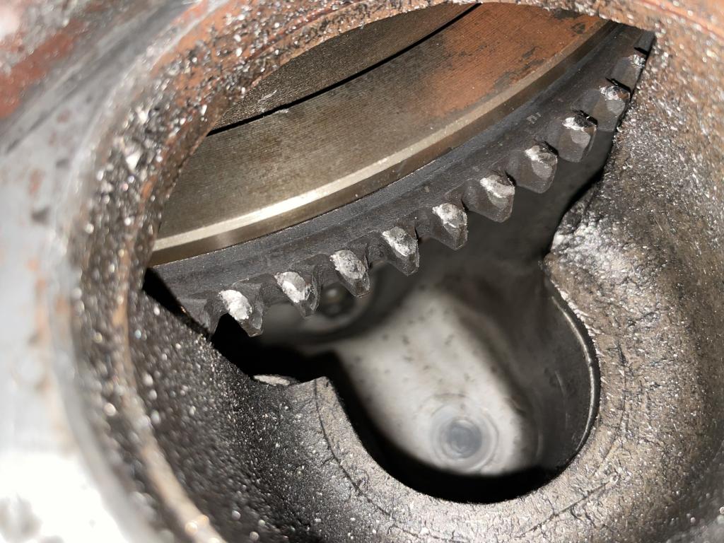

    Pulled the starter and the flywheel looks pretty mangled. Can the bendix throw be adjusted? The starter I bought was from RN and it's the high torque starter motor for Series II-III model # PLI029.
    My follow up question is, did I get a defective starter or am I going to have to try and source a different brand. Or do I replace the ring gear and that should solve my problem.

    The ring gear shows signs of wear, that is part of the problem, now so is the drive on the starter, the other part of the problem, you should replace or renew the flywheel teeth, and repair or renew the starter gear,
