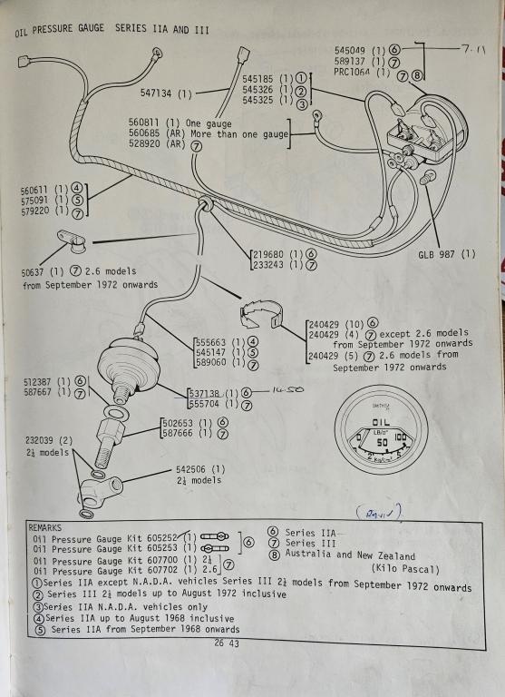

    The thread is a standard RH so counter clockwise to unscrew. It only about 3/8" dia so should unscrew with a spanner on the hexagon without too much force. As you can see in the attached picture of the parts list, which may help you understand the assembly , the sender screws into an adaptor .

    Thanks for the diagram - very helpful. Where did you find it?

    Quote Originally Posted by IIA View Post
    Series 2A/3 Optional equipment catalogue. There are a lot of items fitted to Land Rovers that are standard in some markets but are only listed in the Optional equipment catalogue , such a S3 steering column locks. For info N.A.D.A. is North America Dollar Area
