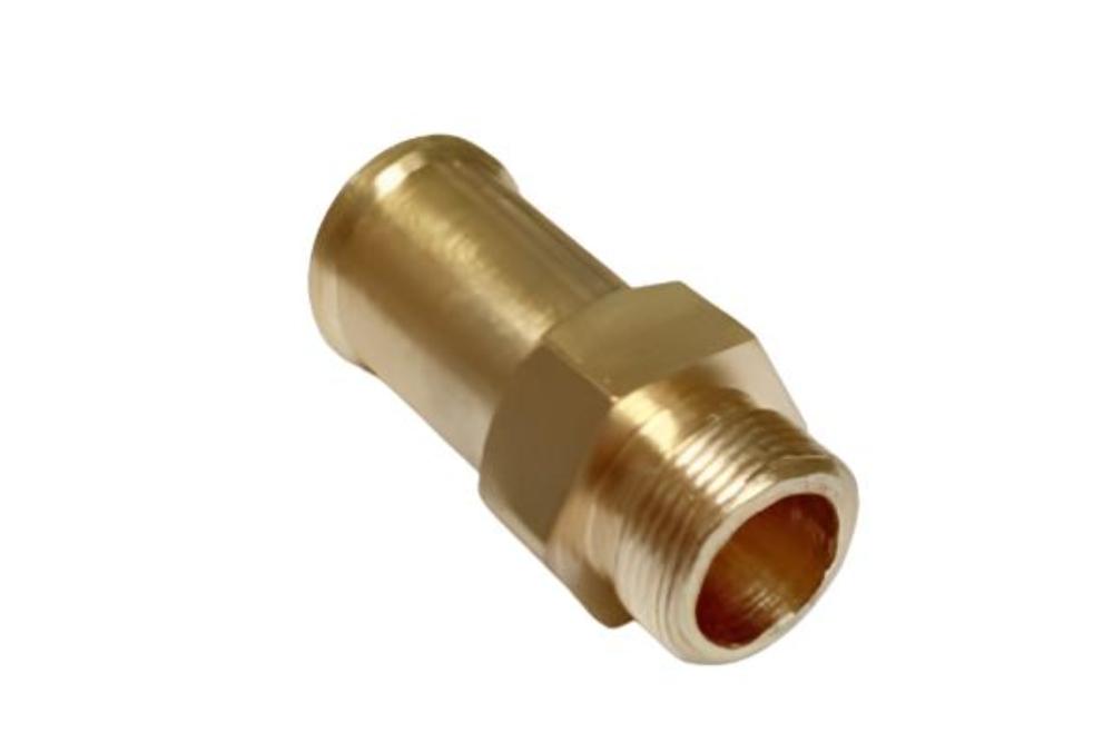

    Part needed, used or new. I need LR part number ERC9453. It is the fitting for the heater hose on a later 2.25 or 2.5 engines. It is a fitting with the thread 16m x 1.0. Some of these heater hose fittings used a tampered thread but this fitting threads into the head at the back of the 4 cylinder metric engines and is a straight thread. If anyone has such an item from a donner engine or a source in the US please let me know. RN does not have it. Thanks.

        Blanchard have it listed & I think they will ship to US . Similar price to Turners. https://pablanchard.co.uk/Heater-Out...Petrol-ERC9453.

                    Item number 163513472362 on ebay is a M16 x 1.0 male to 3/8 NPT female adapter. The seller is a place called Fittings Space. You could then use a 3/8 NPT to 1/2 5/8 hose barb.

                      Bob - Many thanks!!! Got to keep a bookmark for this place. In all my google searches Fittings Space never came up. Just placed the order. Found out that they do not advertise on google. sales person said that I am not the first land rover customer looking for these kind of fittings!

                        Glad to help. You'll likely need a copper sealing or crush washer for the fitting to cylinder head joint, but like the hose barb they should be available from plenty of places.
