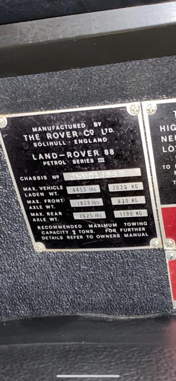

      Thanks Les! I'm awaiting pictures at the moment. The serial number he gave me is: 325901495B
      • Dakotaman
        Low Range
        • Jun 2021
        • 10
        #4
        [attach=config]13680[/attach

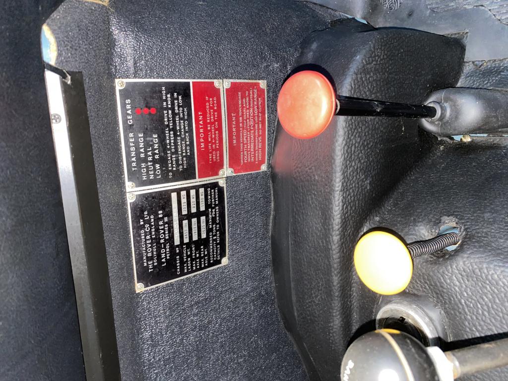

            The owner was off by one digit. It is actually 25901495B. I apologize if you can't view the photos very well. I'm struggling to figure out how to post photos.

              Maybe other folks have more info, but here's what I could dig up:
              This just says "Series 3, 88inch"
              I looked in my copy of the book "Land Rover Series III, Specifications Guide" by James Taylor(ISBN: 978-1-84979-320-7) and he has this entry:
              "88inch Federal De Luxe Hard Top
              259-00001A to 259-03572A
              Petrol (4 cylinder) LHD, export"
              If you have time, you can have the British Automotive Heritage Museum look up the car and get some neat info. I did that with mine. It costs like $45, and takes about 3-4weeks. But they send you some details like original body color, options, etc. They have all the original records. You can get a little certificate, too, on their letterhead. My wife called it a birth certificate for the Landy.
              A Heritage Certificate is a certified copy of your car's entry in the original factory ledger, showing the specification as it left the production line.
              I'm sure there might be other ways to tell a NAS Rover, maybe by equipment required for import to North America...like original seat belts or...I don't know...reverse lights. Might be able to narrow it down by original installed equipment, too.
              Good luck!
              FYI - those tin plates with the VIN number on them are not always legit. You can buy reproductions on eBay and hand stamp them. Also, they are only held on by rivets or screws.. There is a VIN stamped on the frame, just in the Right Front wheel well...on the spring hangar. You can ask for confirmation photo of that, too. Might be covered in raod grime and need some scraping...but it's there. Unless it's had a new frame fitted...which might be a good thing, depending on your goals(OEM only, or upgraded restoration, etc)
