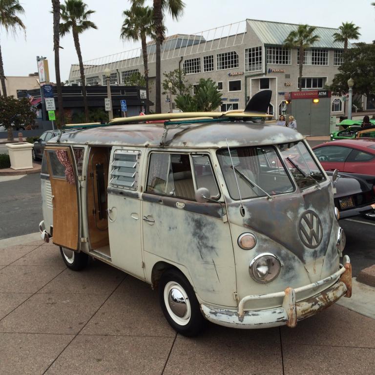

      Worthwhile101, I had a 1966 split window bus with 100% OG paint, literally (pic attached). Same as you, I wanted to preserve it as is. I used TR3 Resin Glaze every 1.5 - 2 years... even on surface rust areas (which basically became somewhat shiny, but not obnoxiously so). The bus was garaged, thus protected more often than not from the elements, which surely helped. I applied it by hand (no buffing wheel) and learned not to be too aggressive since that tended to thin the paint further in existing very thin places. Overall, I'd do it the same way if I had to do it over; it looked tidy/polished but not screaming "SHINY".

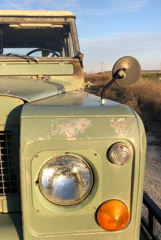

      I have a patina'd '71 88" late 2A with mostly OG paint and I'm leaving it alone. The buses patina looking somewhat polished worked well (not radically shiny like ugly clear coat [IMHO]), but the Landy seems fitting to me to have a more flat appearance than polished. It has a slight sheen to it but I don't want to encourage much more. It's garaged, so it'll be fine untreated. All personal preference. Some folks I know use Gibbs oil on their old paint cars but it seems to me it is a dust magnet, like Armor All was back in the day on our tyres. Good luck with your project.
