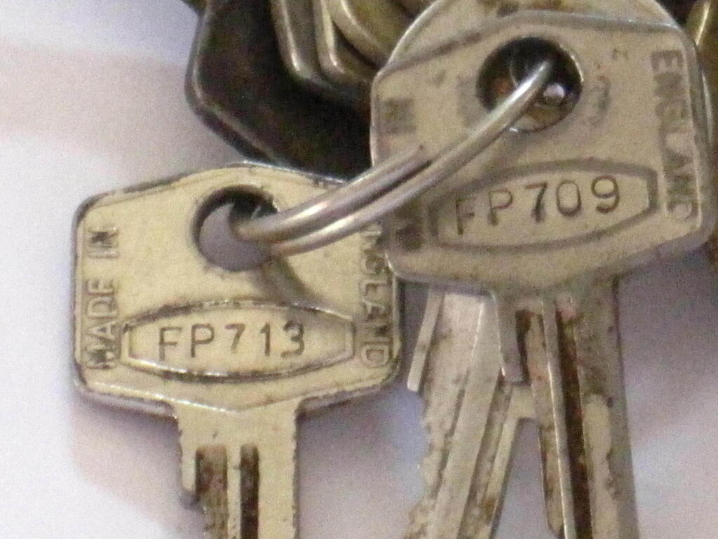

    If you are looking for a visually different key, Triple C has several different shaped key blanks available. You need to know what type tumbler you have. I think the FS and FP were the types typically used. On some the key or tumbler has the type and key code stamped. Some years ago I replaced the tumblers and keys on the wife's SIIA and my SIII with the different shaped double sided FT type key.
    The tumblers can be removed using a thin rod or drill bit to depress a button on the tumbler. In one position the tumbler will line up with a small hole in the switch body allowing the rod to be inserted, but the small tumbler button often sticks.
    Triple C: https://www.triple-c.com/Keys_-_Replacements.cfm?sc1=9
    FT Key:
Name:	FT key blank.jpg
ID:	193681 Click image for larger version
Name:	Key numbers.jpg
