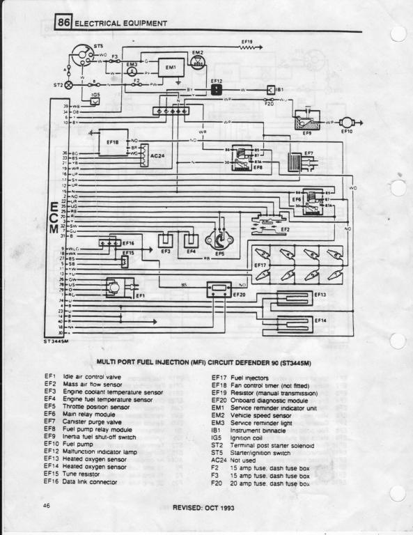

I got up a few weeks ago to go to the Uwarrie Safari, I fired up my 94 D90 NAS and moved it to the waterhose to knock the pollen off. Had it all loaded with camping gear and and stuff, and when I got back in it to fire it up and head on to the adventure, I didn't hear the fuel pump and it wouldn't start.
So I didnt get to wheel.....at Uwarrie...BUMMER... and it was my first trip to do something fun in the 2 1/2 years I've had it.
I checked the fuses, and the inertia switch...they were good so I assumed it was the fuel pump,
got a new pump and installed it..still didn't work. (now I got a used spare)
I checked the power at the fuse and there was none.
So I'm hoping ya'll can help me out, I need to get this thing running before next weekend so I can take my nephew to an Airsoft game... BLAST 'EM ALL !!!
Thanks
