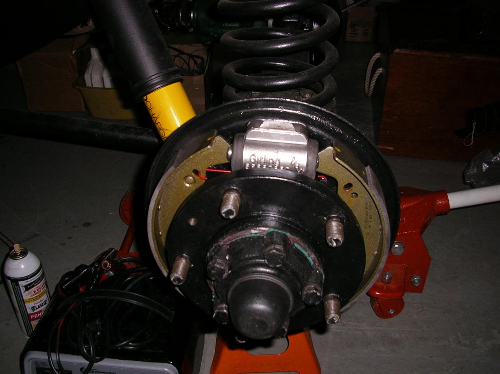

          Les had reassembled as it was when taken apart, although a quick look at shop manual might be wrong.
          One leg of the top spring is to the post on the backing plate.
          added a pic of each side.

            Had some help from welder.
            placed spring on both upper legs of shoe's.
