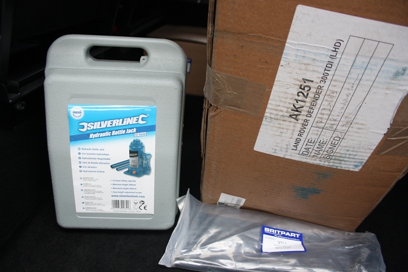

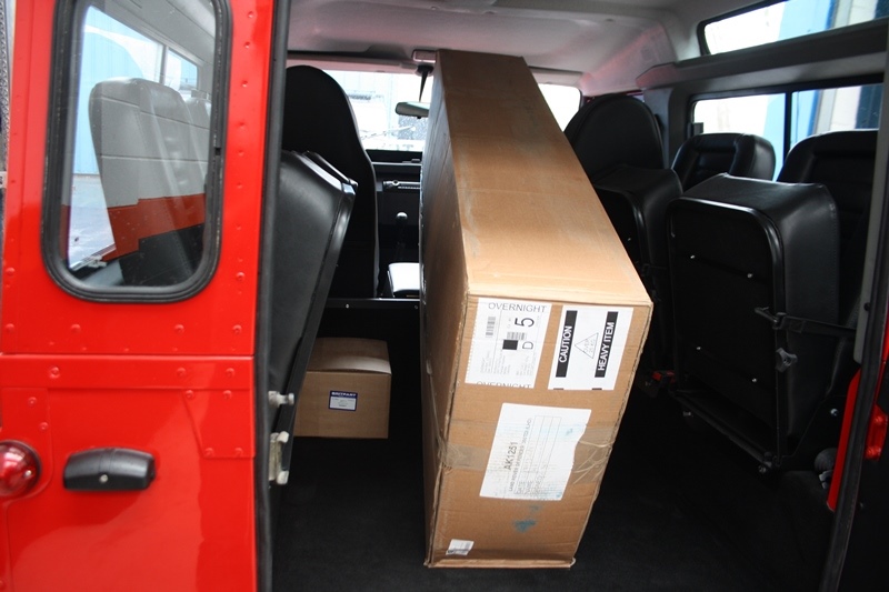

 Les - Everything in the italics below is from the General Manager of the dealership in the UK where I purchased the vehicle. After I received the attached photos today I am now actually rather concerned and somewhat miffed (pissed off for lack of a better word). Based on what I can read - and I can read English - the box says 300TDi (LHD) - so exactly how is that supposed to fit on a 2.5TD? It wont based on everything I have read and I am reading.There is no pulley that Landrover offers that will work "off the shelf". I'm not sure where the info came from detailing approx 5" diameter pulley for fitting on the water pump. We can supply the tensioner/idler pulley for the 300 TDi, though I would have thought that would be in the kit.
 The 300 Tdi pulley (on the centre front cover) # is ERR3735, I'm not sure if this will bolt to your water pump though. In stock, price is $252.78
 I did not pay extra for the kit - it was part of the vehicle. They stated they did not want to install it because it could have caused issues with importation - I think they did not want to install it because they could not install it. This is going to turn into about the biggest SNAFU I can possibly imagine.
