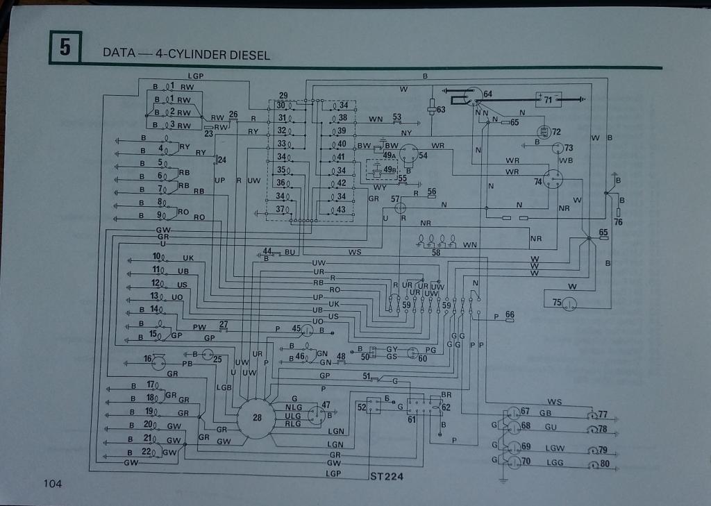

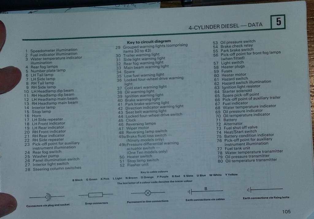

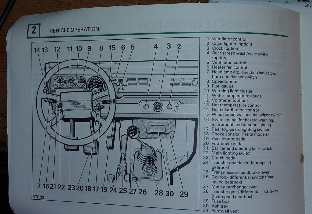

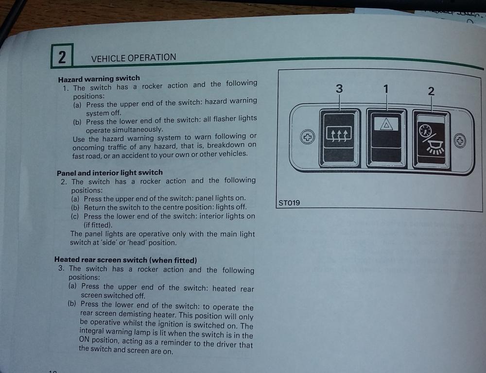

    Pictures from 1984 Drivers Handbook for LR 90/110
    . It does show a combined interior and instrument panel light switch but instrument lights appear unfused. Item 16 on the dash panel view Click image for larger version

      Thanks just seeing this now, appreciate the info, following the wiring diagrams appears all the wires are there but we're missing the switch.
