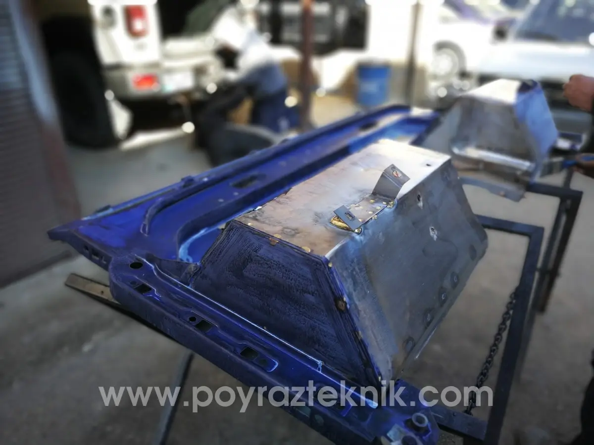

    Application Process
    Surface preparation is critical before rust converter application. First, thick rust layers are removed by sandblasting, then fine cleaning is done with sanding. After the surface is made completely dry and clean, rust converter is applied with brush, roller, or spray.
    The product typically requires a 24-48 hour waiting period to chemically react on the metal surface. After this period, the surface is covered with a black-colored, protective layer, and primer-paint application can be performed.
