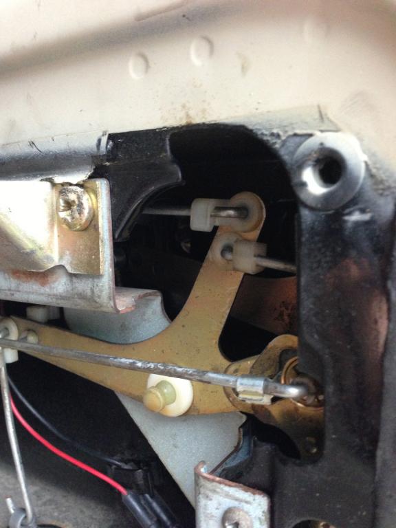

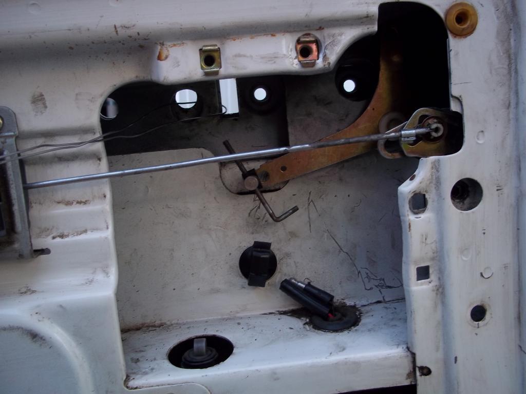

    Hello,
    I made a mistake and tore into my rear cargo door lock mechanism like an animal! I hade to replace a broke little spring. I usually take notes or pictures of such a complicated mechanism, but for some reason I did nto do it this time.
    I replaced the spring and lubed everything back up, but now I need to hook up all the little rods and such.
    Does anyone have any photos of what it looks like hooked up? I will be extremely grateful and promise to return the favor at some point in time. Attached is what it looks like now.
    1994 Disco 1 with automatic door locks.
    Thanks-Todd

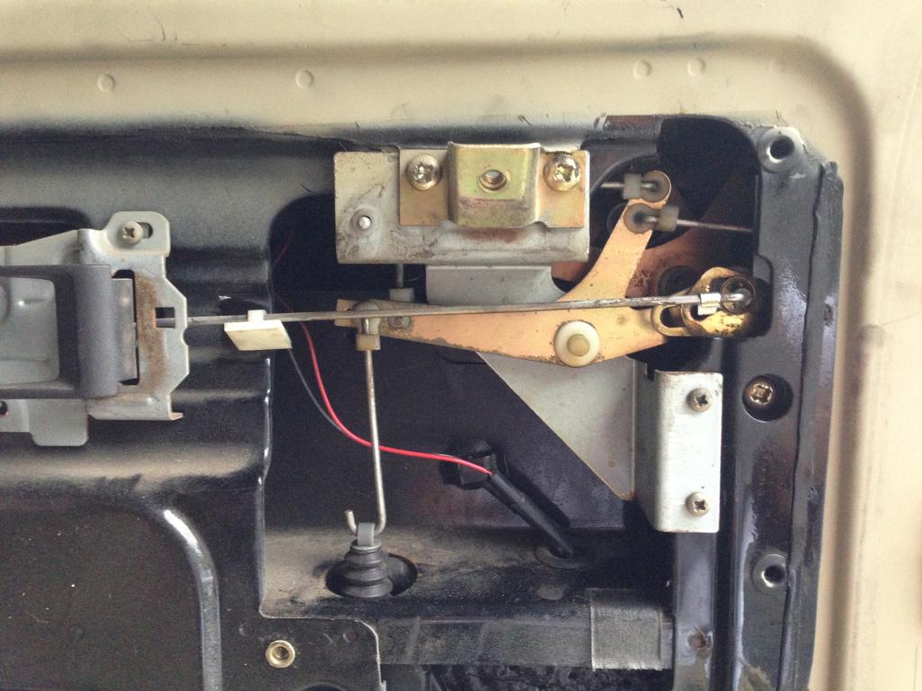

    "Out of every one hundred men, ten should not even be there, eighty are just targets, nine are the real fighters, and we are lucky to have them for they make the battle. Ah, but the one, one is a warrior, and he will bring the others back"

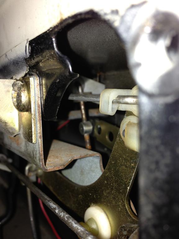

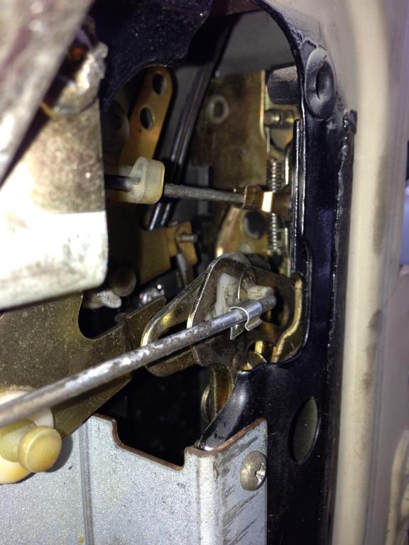

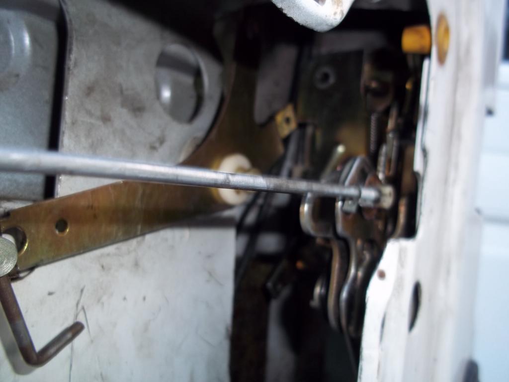

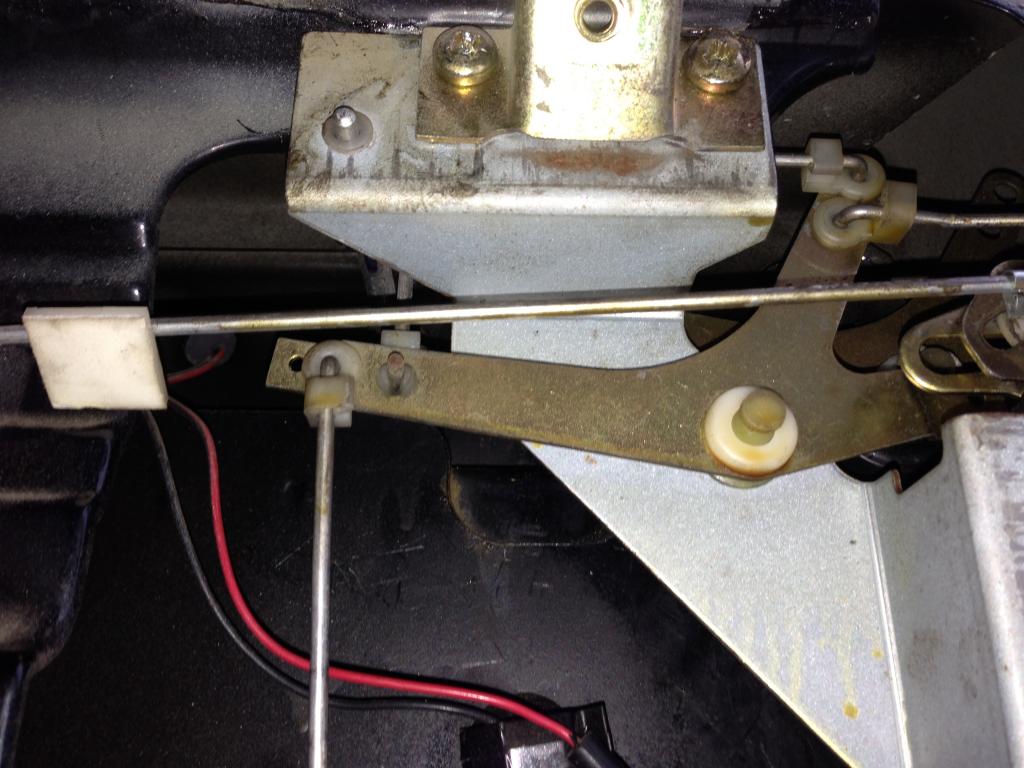

ID:	168069Click image for larger version
ID:	168070Click image for larger version
ID:	168071Click image for larger version

        dandruka, thank you very much. This should definitely get me going in the right direction. Thank you for taking the time to help me out. Have a great day.
        Todd

            Hello,
            I made some progress. I appreciate your photos greatly. If it isn't too hard, more would be helpful. Especially out in the pocket towards where the picture 2387 you sent earlier shows. Also, straight ahead where the handle comes through the door and the auto door lock actuator connects.
            If it is too hard I understand. Thank you again.
            Todd

              GOT IT ALL BACK TOGETHER AND WORKING GREAT.
              Todd
