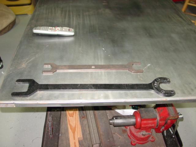

    What tool are you using? I looked at the RN site and couldn't find the correct tool offered. The Rover tool is actually 2 wrenches, one goes on the big nut on the clutch, the other is an even bigger wrench that holds the clutch hub in place. I bought mine years ago when I worked at a LR dealership (the shop had a set but I could never find it so I bought my own). I've since retired. It is possible to get the S belt off without removing the fan but it's a lot easier if you do. You might try jamming a long screwdriver between a couple of the attaching bolts on the fan clutch, never tried that but it might work. GL

      Yeah, I got the double ended wrench. Which doesn't work on the clutch. I rented a specialty tool from autozone that didn't fit either. Thanks for the info. Is there a site you know of that offers Land Rover specialty tools by chance? I googled it but couldn't find anything useful. The tool that RN sells isn't for the clutch then?
        The only place I know to get the tool is an authorised LR dealer. The tool is made for both diesel and petrol, I've attached a picture. The double open end wrench is part number LRT-12-094 and the petrol end is 36mm (this is the one that fits on the big hex nut on the fan, the other wrench(bottom one) is part number LRT-12-093 there's no size on it but it fits around the hex nut and the holes fit over the studs and nuts on the clutch to hold it in place. The thread on the hub is standard RH threaded so lefty loosey (as you're looking at it). IIRC I paid $75.00 for both of them 11 years ago. HTH
