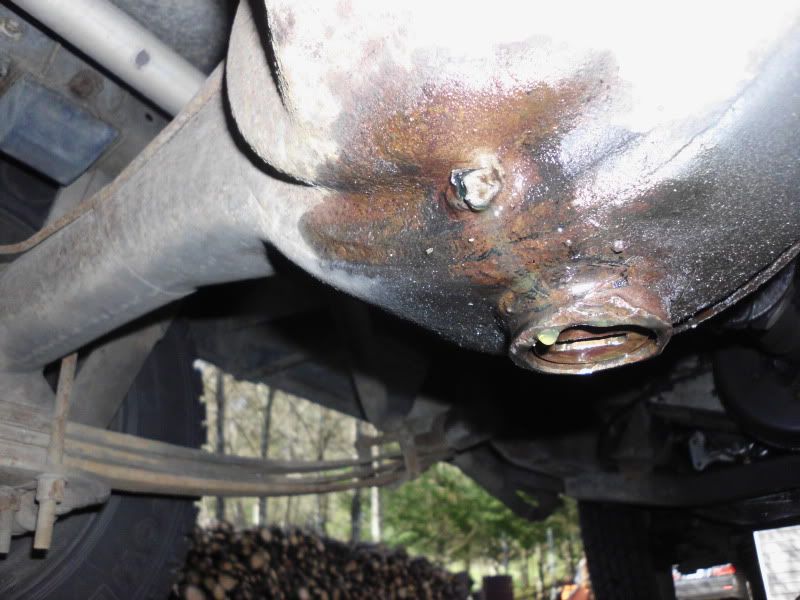

    I check and change fluids pretty religiously. When coming home from work one evening I heard a bit more drive train whine than I'm used to (nothing extreme) so crawled under today to take a look. I drained and replaced the front diff and all was ok. Then looked at the rear. Uh-oh. Steady drip. At first I thought it was from the drain plug but then I noticed this...It looks like something has gone through the case from the inside.

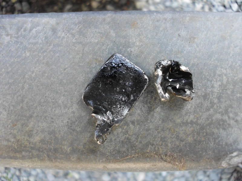

    I opened the drain plug and very little came out but these two little pieces fell out too. I'm guessing this isn't a good sign ?

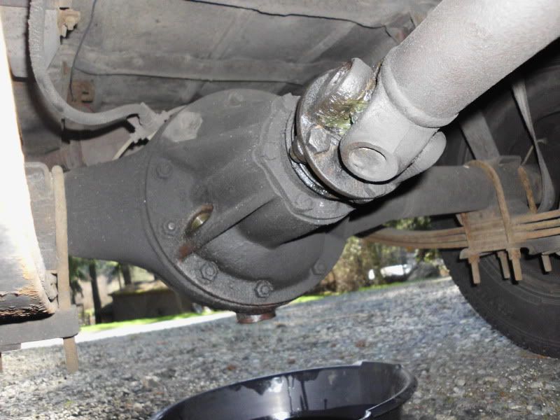

    Here's a front shot of the diff. - can anyone identify it off the top of their head? Yes, I'm being lazy...

    Take the diff out and get a look at it. It is all just speculating until then.
    Yes, the case can be welded.
    The bits might be bits of a bearing cage or bits of a gear. It is hard to say from the pic.

      Looks like the standard LR diff. You'll need to drop the drive shaft, pull the axles and then remove the diff to see how much damage has been done. It's a moot point as to what the metal bits are. The housing should be weldable by a competent shop. Depending on the damage to the gears and housing, it may be a do-it-yourself job. But one can always source a replacement center section and meerly change it out, once the gear ratio is double checked.

        If not worried about originality, a secondhand unit can be had for cheaper than rebuilding. I did that getting a good ser3 diff from Roverworks for the rear of my ser1. Also,there is good epoxy weld kits for leky cases, just made for that very job. usually from heavy duty equipment shops.

              Just a Series diff. The main difference between it and later ones is the early ones like yours used a separate retainer for the oil seal (the part with the 6 bolts at the pinion/propshaft).
              IIRC, they use the same ring and pinion, though the pinion bearings are different.
