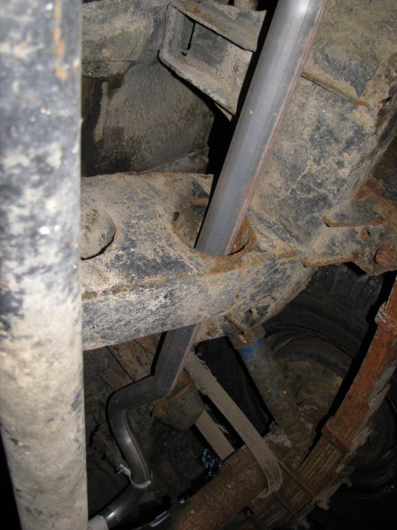

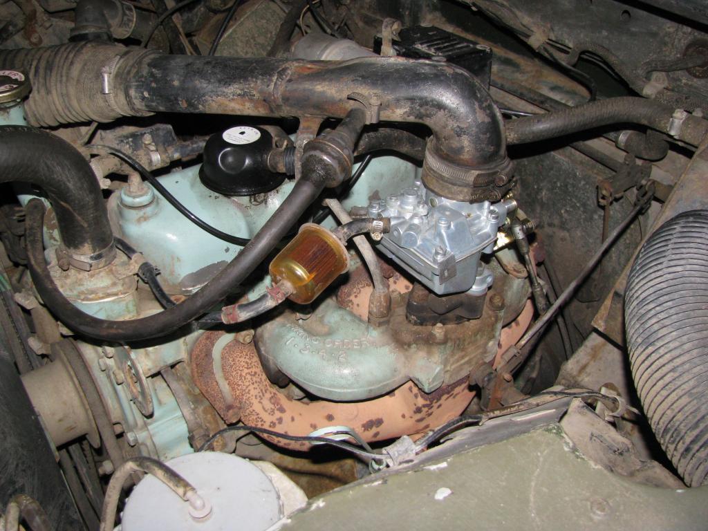

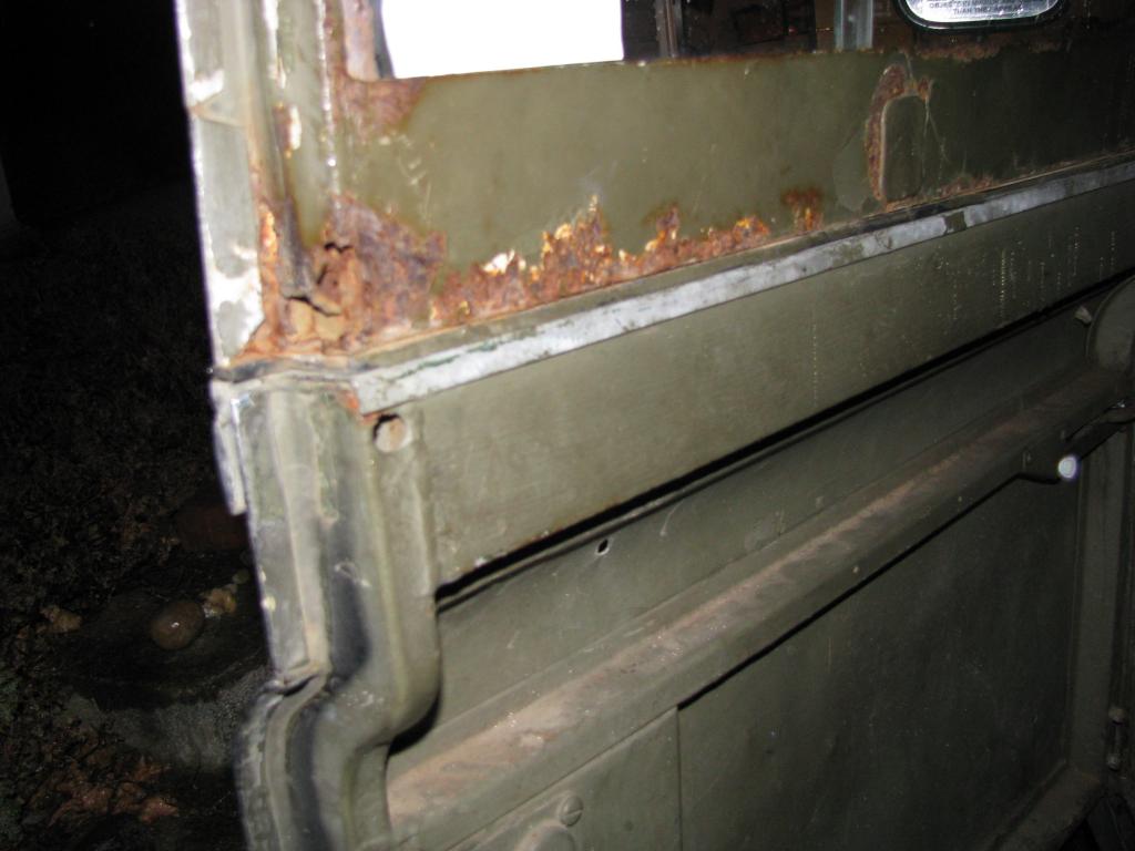

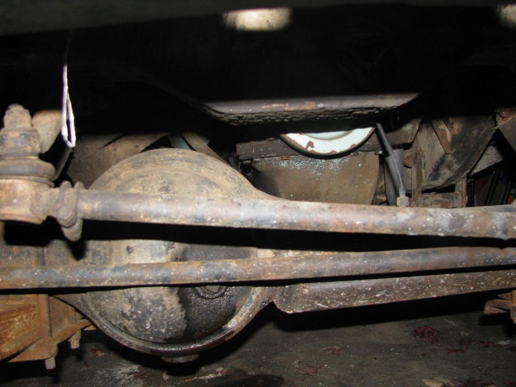

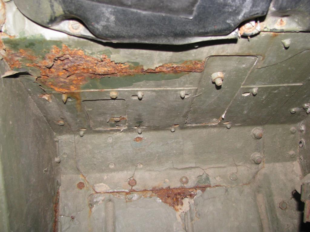

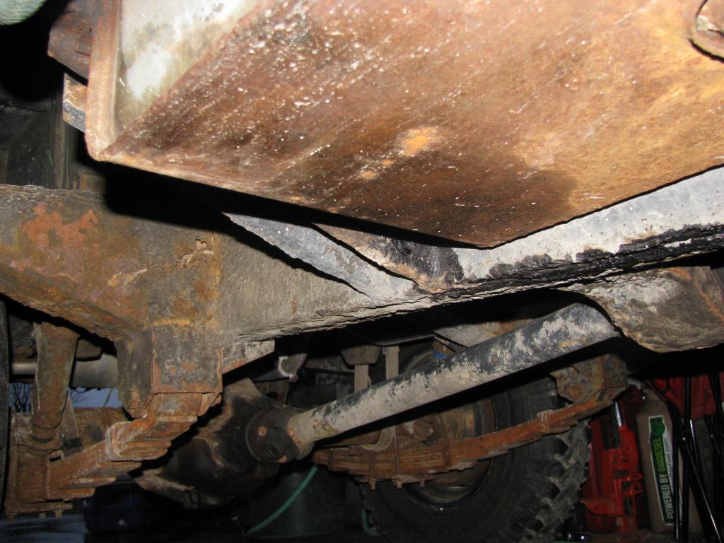

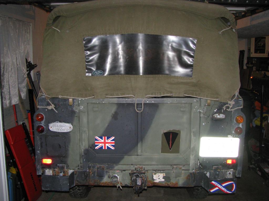

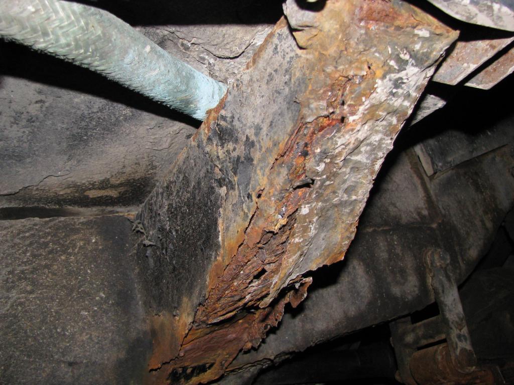

    I am looking to purchase my first Rover. I have found this '73 109 FFR that the owner wants $7700 for. It has two bad outriggers, a malfunctioning speedo, a rotted out rear cross member, rot in both door tops. It is about 10 hours from me so I have been getting my info through email exchange. Owner seems very willing to provide all the info I have asked for. I have several pics but am attaching just a handful that seem pertinent. If anyone sees anything in them that I have not already mentioned or can give me further help with bargaining. I get the feeling that this is more of a $2500 truck. What do you guys think?

      Pass. The bulkhead and the frame alone are going to cost you about 5-6000 dollars, by the time you get into this, you will have probably another 5 grand in "as long as I'm in this far" add ons. Then you'll want to replace seals, brakes,etc.
      This is a 15-20 thousand dollar project

          $7700
          Because of the new exhaust on it??? Stay away...

            I'll agree with everyone else that this vehicle is overpriced. The seller either doesn't really want to sell or believes they have a very rare vehicle. Is the vehicle even worth $2500? Maybe if you just have to have a 73 109 FFR, but otherwise I say no.

              X2 to the prevailing opinion on this thread: IMHO this truck is way overpriced and you will spend mucho to get it fixed up.

                I don't know guys. Yeah, there is some rust. But, if the truck is good runner with all other systems functional, it could be worth a bit more than the $2500. Though definitely not the asking price. Depends somewhat on the OP's ability to cut and weld, and lots of other factors including whether it is going to be a full on restore or just an attempt to fix the big problems and just get the thing back on the road.

                  Just looked at a much nicer tuck for a fraction of that asking price this week...
                  Agree with the others who are suggesting caution.
                  I also agree with daveb, there's a lot to be said about the conditions of all the other systems. If it's a good runner with frame rust and some rot, you might be several years of fun out of it before needing to tackle anything too serious. That said, one has to wonder if the rot is indicative of the overall condition.
                  Still, find some comps, use those for comparison and, if needed, bargaining.

                    Being your first Rover I'd say this vehicle is a N.E.F.F. [not even for free]. If you want a $10,000 Rover, buy one for $3,000 and put $7,000 in it and get back maybe $8,000 when you sell it off. Or just buy the best condition Rover you can find at a reasonable price and save youself some headaches. Take your time and shop around, don't get the bug and jump on the first one you see, because sure enough a really nice one will come along just after you buy a fixer-upper.

                      The military Rovers used undercoating which can actually hold in salt and moisture while concealing the damage it has done. If those are the very worst spots then maybe it isn't all bad but you really need to examine it up close and consider all the other mechanicals, body, etc.
