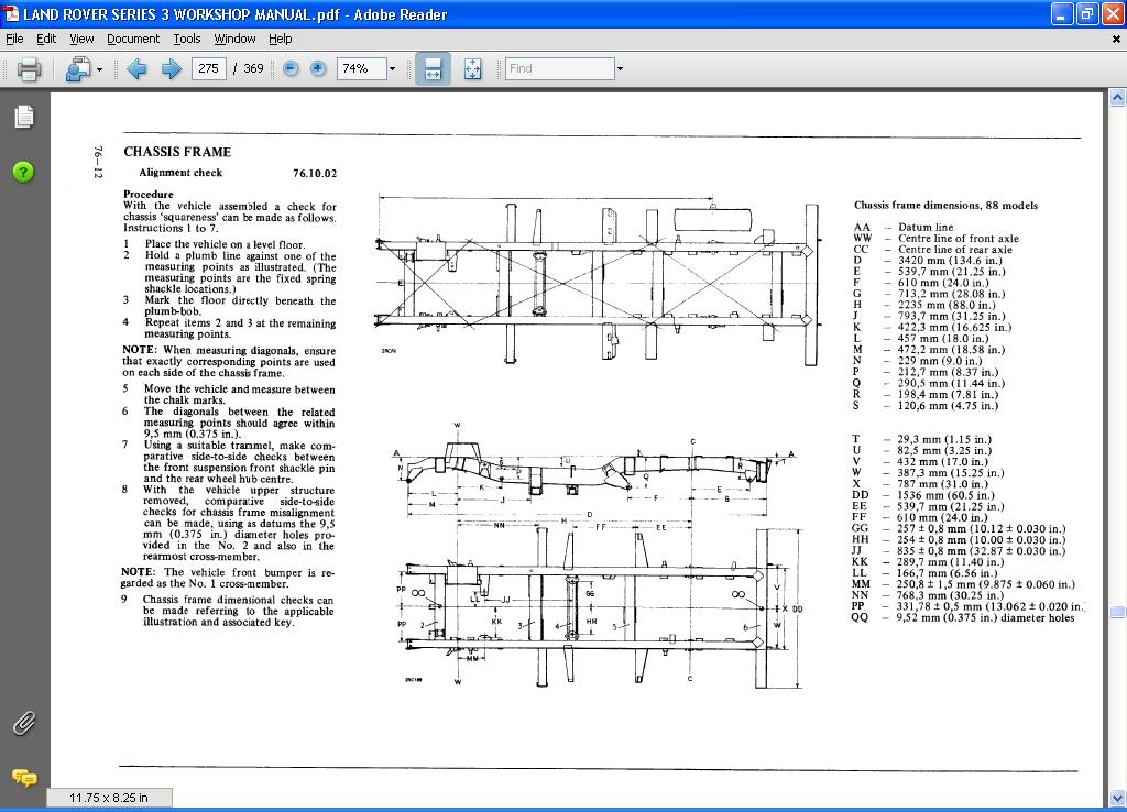

    The back end of my 88 Series IIA chassis is rotted out and I need to rebuild it. Unfortunately, it got whacked on the driver's side (LHD) rear frame crossmember and, although it doesn't appear to have distorted the side rails, I can't be sure and, in any event, I'll need to bring that part back into spec. Oddly, the front of the chassis (back to about the rear axle) is fine - the original paint and even some factory grease pencil markings are present on the front part. Does anyone know of a source for a chassis drawing that includes dimensions and would be sufficient for a competent fabricator (me) to build a chassis from scratch? I have considerable experience with hot dipping stuff at a local galvanizing plant so I plan to hot dip the chassis once I fix it.

    Series III dimensions found on google images Click image for larger version
