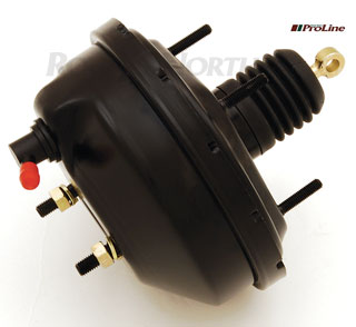

                      Hi all,
                      What does the booster check valve do? Any pictures of what it looks like?
                        In this picture it's the thing with the little red dust cover on the end on the upper left. Yours probably won't have a red cover on it though as that is either for an extra vacuum port or just for shipping.
                        Basically it holds vacuum in the booster canister after the engine is shut down. This is done in case the engine stalls while moving. The theory is that it will give you a couple of uses of the brake peddle before all boost is lost.
                        Any car with vacuum boost brakes will have something similar, so you can see what I mean by shutting down the engine of your favorite car and fully pressing the brake pedal a couple of times. Eventually it will get really hard to move the pedal until you start the engine back up again. The booster on series brake systems aren't all that powerful so the effect isn't that obvious, but you can still notice it if you try.
