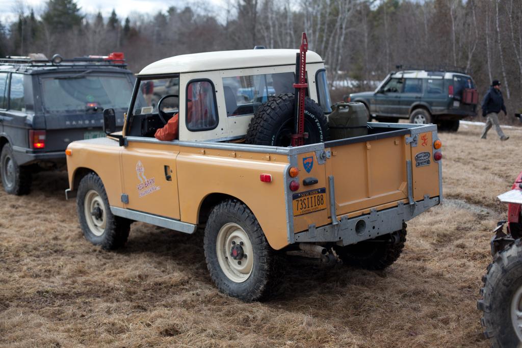

        It's certainly open to personal preference, and granted this is a truck cab, but I saw this at the Winter Romp.

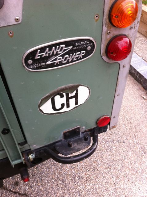

                I have mine mounted on the back crossmember corner, where a PO welded a tab with pins for locating it. Figured I should reuse what was there and I just spray the mechanism now and then. Front bumper was my next choice. Click image for larger version
