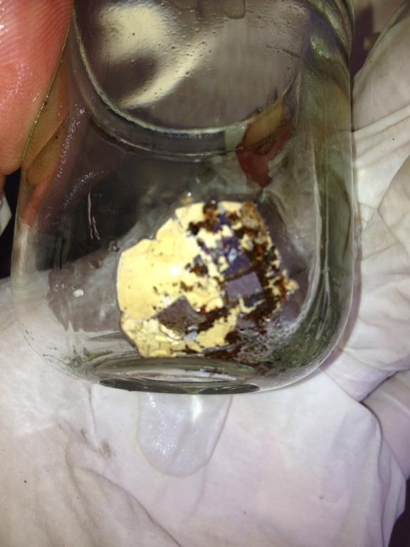

                        I have this exact same problem with my '63 IIA with weber 34ICH and stock (or at least stock style) mechanical fuel pump with sediment bowl. I have a clear filter so just looked and sure enough, instead of the usual near half full, it is basically empty (say 1/4 max) after sitting for a while after a drive. Does this mean it's the fuel vaporizing, and is the recommended solution insulating the fuel line?

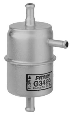

                          Originally posted by ricker
                          H
                          I am not familiar with a bypass fuel filter and don't know whether either of my filters are bypass or not. I would appreciate more info. Mine has never failed to start it just takes 5-10 seconds to start after warming up and then turned off for 10-20 minutes. After 45 minutes or so it fires right up.
                          It is a filter with three places to put a fuel line, one of which you run back to the tank. Thatt way you get a constant supply of cool fuel from the tank in the fuel lines. They look like this:

                          (I think the Fram G5387 is the #?)
                            I would bet your weeping fuel back through the pump. I won't assume the hose being used but I am going to guess at 3/8" which has a sizable wall thickness providing decent insulation. I would still lean towards something else in the system is amiss. I haven't seen an insulated fuel line in practice, at least not used to combat vapor lock, usually to insulate from close proximity to the exhaust manifold.
                            My 79' F250 runs a factory hard line from the pump alongside the block under the water pump and it doesn't exhibit any issues due to heat, I will venture a guess that my 460ci runs hotter than a series motor. The only time I have seen a heat issue affecting the fuel stability was with a 427 Cobra, which ran inherently super hot, no under hood ventilation, 0 mile tight motor, inproperly tuned and jetted. I added a carb spacer, got the timing and jetting right and never had an issue.
                            Hot start is pretty common, if it starts WOT I'm ok with that, as long as it runs and op's fine once started, but I will assume that all of the millions of Series produced don't experience this problem therefore you have something else at play here. Make sure all the other systems are spot on, valves adjusted, compression good, leads and grounds clean and healthy, plugs, check, fuel pump solid, tank's clean etc... if all else checks out then what else is there?

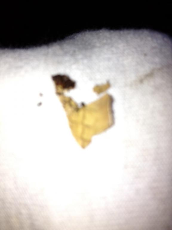

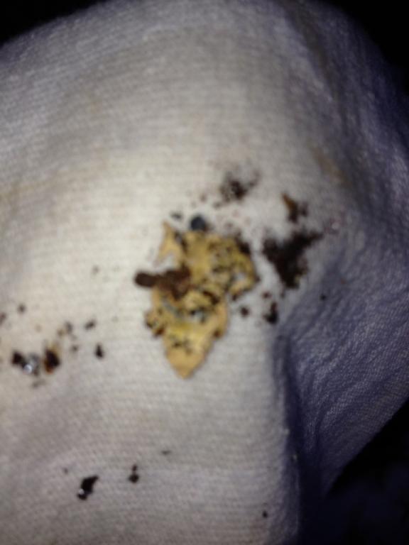

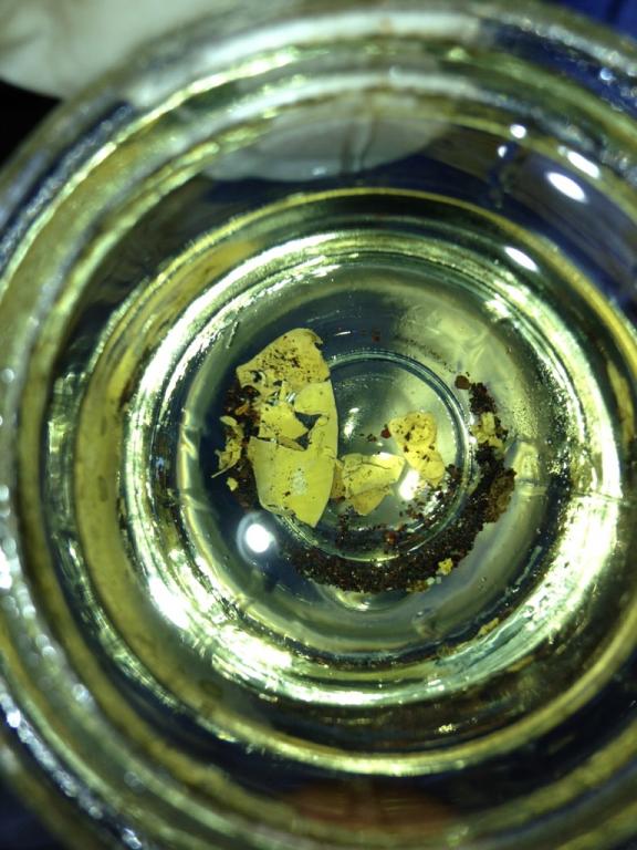

                              #15
                              I have a hard plastic line up to the filter - looks to be smaller than 3/8", so maybe 1/4". If the fuel was draining back (which seems like a very reasonable bet to me), what makes it ok after sitting long enough for everything to cool? That's the part that is baffling - you would think once drained it wouldn't come back.
                              I have seen modern fuel injected cars need a bit of gas pedal to get them to start when hot.
                              I will try WOT next chance I get and pay attention to the fuel level at cold start as well as after short stop and longer stops. I have had other fuel related issue which I'll describe, but am not sure of they are related. Almost randomly my truck will alternate from running perfectly to having zero power without the choke pulled all the way out. Sometimes it can alternate between states multiple times in the same trip, and sometimes it says good or bad for extended periods. I noticed it went from good to bad the other day after hitting a bump which might be an indicator of junk in the fuel clogging things up. It seems to run fine otherwise and idles great. I adjusted the valves yesterday but they were at 0.011 before which I think is acceptable.
                              The good/bad thing is my truck is running great right now so none of these symptoms are present. It's hard to say things are a problem when they are not causing the problem at the current time. I noticed some junk in the fuel pump sediment bowl yesterday so cleaned it out. I went to see if the fuel pickup was clean but when I pulled the access cover the hole where the line goes into the tank looked smaller than I expected to see so decided to leave it for now since the problem is gone for now and I didn't want to rock the boat. I'll check the green bible so I know what to expect next time. Here is what the gunk looked like. It almost had an alligator skin pattern on the on the yellow (rubber?) almost like what you'd see on dish washing gloves. Maybe I should look in the tank

                              Sorry if this is getting to be a hijack.
                              Thanks,
                              charles
