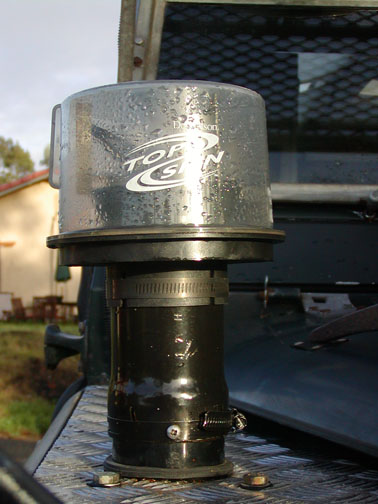

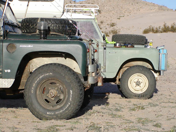

                          Modern earth moving equipment has moved from an oil bath to a prefilter feeding a paper element. I followed their example for better air flow into my Land Rover's 5.0L V8. But I still wonder if an oil bath would last longer in extreme dust situation. So far the prefilter has done a very good job of keeping my paper element clean convoying on dusty trails.
                          I have a Donaldson prefilter that drops into a Donaldson canister filter horizontally mounted to the underside of my front right wing top. The canister filter output goes through the inner wing and is a straight shot into my engine intake.
ID:	166982Click image for larger version
                          The first picture shows the front wing (early D90 outer wing panel) with precleaner and a little bit of the horizontal filter canister sticking out below the opening. The second shows the Donaldison top spin prefiter
