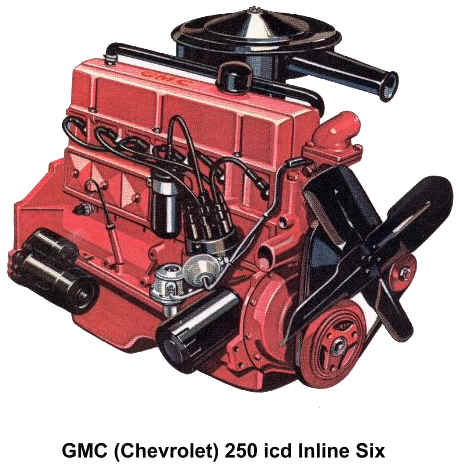

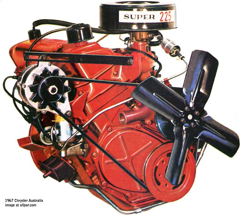

              I like the idea of swapping in a US 6with overhead valves, There are a number of far more robust and easy to maintain US 6s out there that produce good power, great reliability, timing gears, and are easy to get parts for. The Rover 2.6 is a dinosaur- it is a real enthusiast's engine and IMHO offers nothing over a more modern design. If you are interested in 100 point restorations and car shows then it is for you otherwise you'll nearly always be better off with something else. A Dodge slant 6, Chevrolet 250- something like that coupled to a US close ratio 4 speed.
              this
              or this
              If you want a more simple swap the Chevy 4/Mercruiser would be the way to go. You'd need a Land Rover 4 cyl bellhousing and a Scotty's adapter. THIS is probably the most simple swap/upgrade for you and you won't be overpowering any stock parts. Power is good, the engines are great- easy to get parts for, they fit well. Ren Ching has 2 for sale, with the adapters etc:
