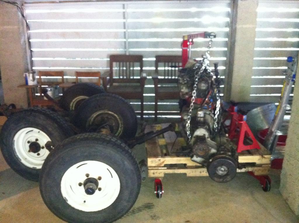

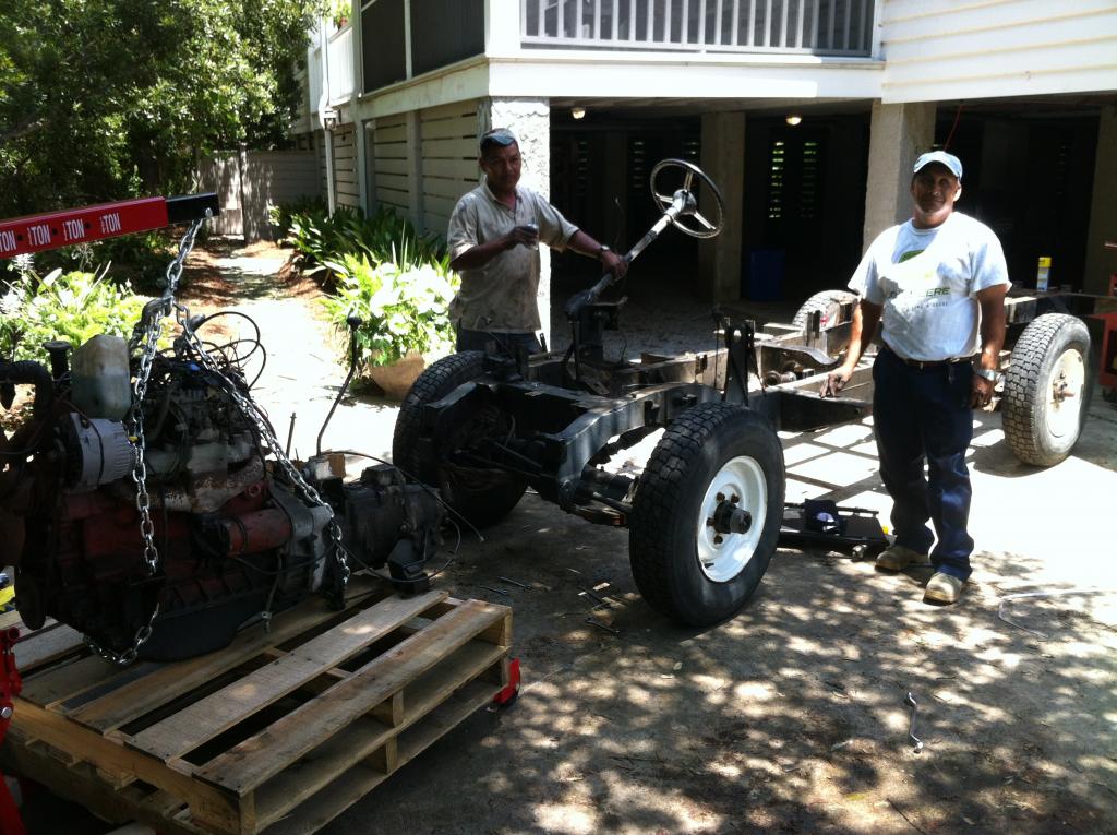

                Some progress today. Motor and transmission out. I would not have wanted to do this solo. There were three of us which made lifting and moving the engine much easier.

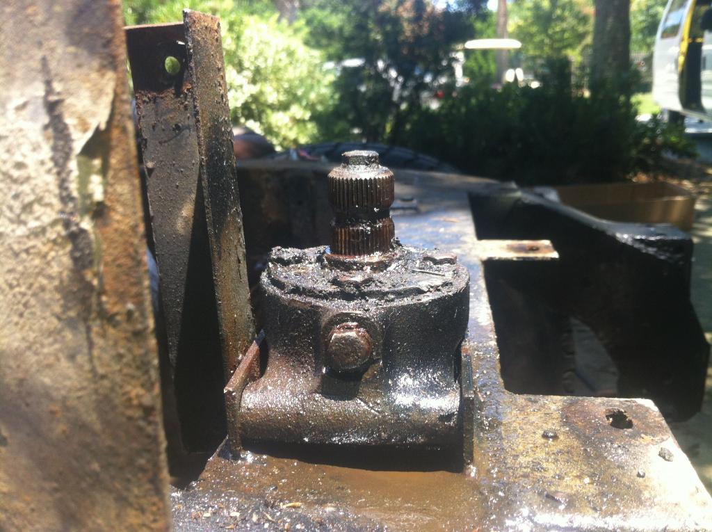

                The bane of my existence. Still not out. Maybe next week. Was very surprised. Did not budge an inch. Only thing coming close to as difficult was the top bolts on the spring shackles.

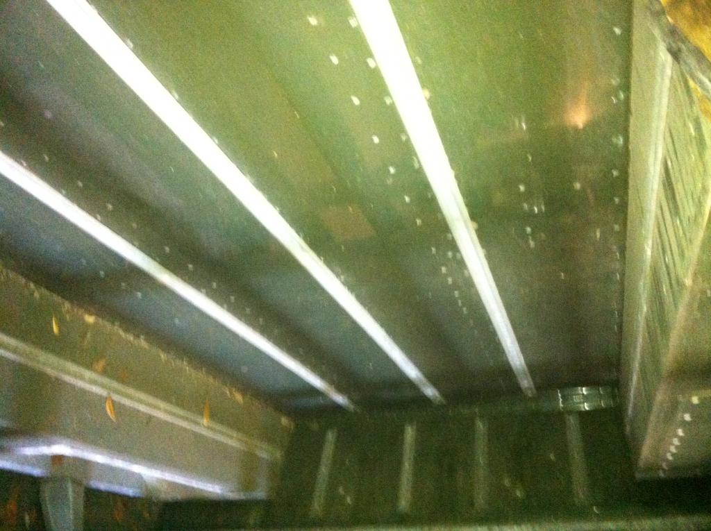

                        It is killing me to have this under the house in a crate that has not been opened since it was packed in the 60's. Twice I have come very close to pulling out the crowbar and opening this but realize it is probably best to wait until right before I put it on the Rover.

                          Oh....go ahead, bust into that birthday present. It might be a good idea to make sure measurements, fittings, and whatnot are all in order so you dont get a last minute surprise during install. Its no fun to have to order extra parts and wait for them to arrive.

                            Don't touch it until ready to use it.

                                The steering relay wins again today. Not for all we threw at it would it budge an inch. What a PITA! We did get the two front spring bushings out.
