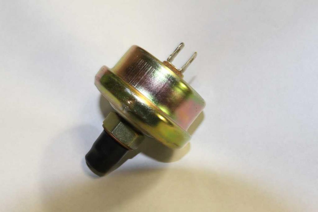

            The Lucas type of senders for the electric oil pressure gauges usually need to be in a specific orientation. Older senders can have the word "TOP" that needs to be oriented at the upper end when mounted. The newer senders just have a small stamp mark on that should be at the upper end.
Name:	Oil P sender.jpg
            Bob
                    Hmm...interesting. I must admit, you've got me wondering what's going on in there that it needs a "top" side. Then again, I've seen the craziness inside the Lucas SIII exterior lights switch, so the pressure sender doesn't really surprise me.
