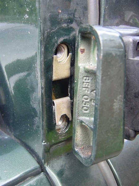

          • crankin
            5th Gear
            • Jul 2008
            • 696
            #6
            Like so:
