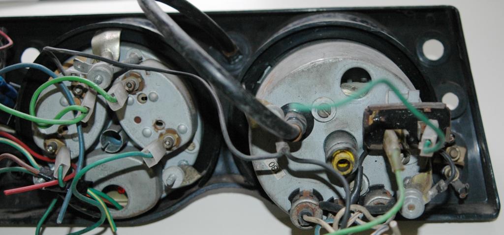

              Here is a pic. of the donor Series III dash panel, from whence came the Voltage Stabilizer.

                Thank you Les!
