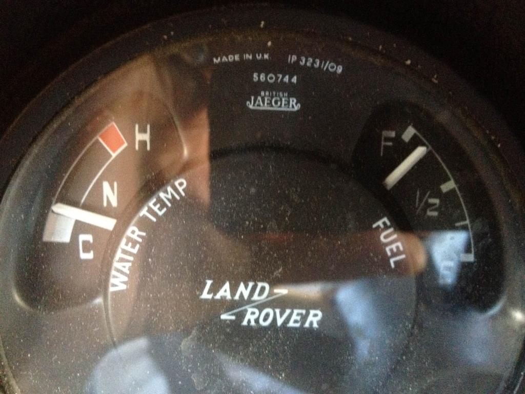

                    Got the new voltage stabilizer and installed it. its about 90 50% humidity drove it around 45 mins did some hills, freeway, stop and go traffic plus I had a somewhat heavy payload. Temp gauge barely moved off the white now. Does this seem correct?
                    Also filled the tank and now the highest the fuel gauge reads is just over 3/4 mark, its always read off the chart when full. ground issue maybe?
