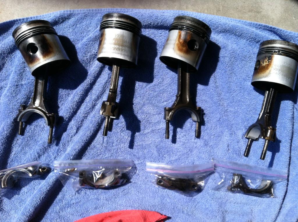

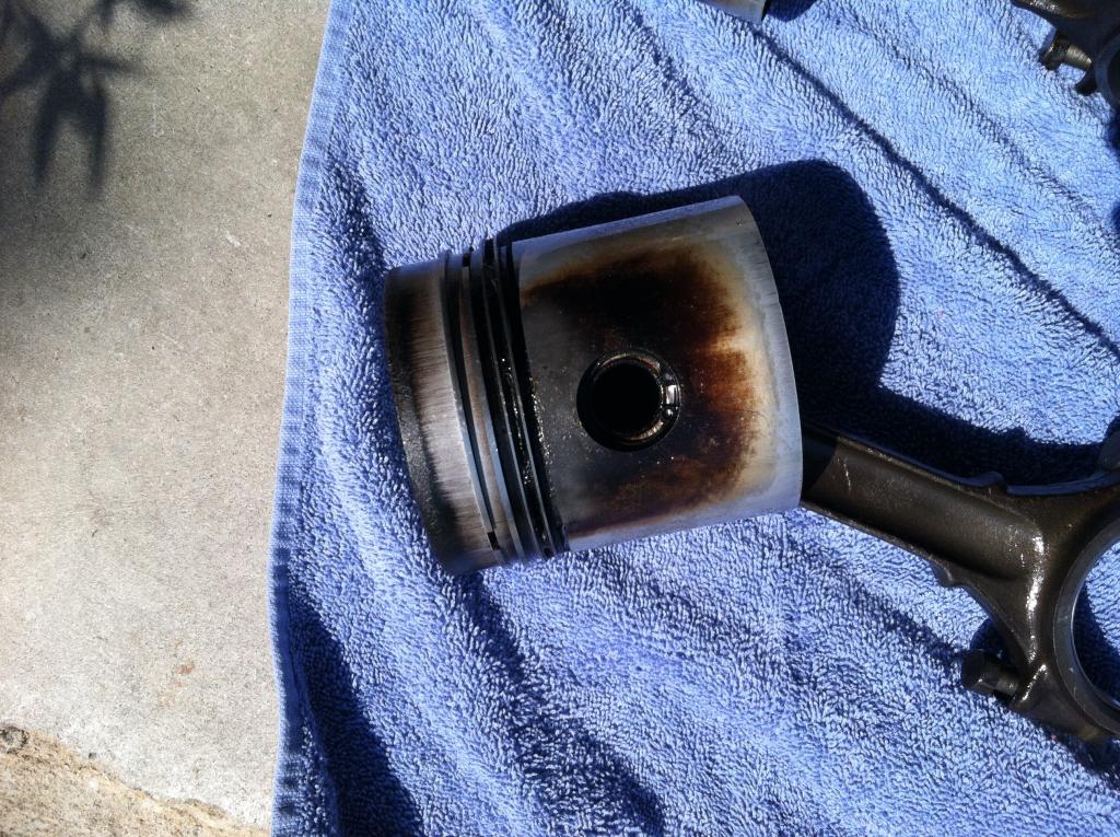

                              pulled the pistons after removing the ridge and here are the pictures, I need to know what everyone thinks, are they burnt out and require new pistons or are they normal and go with them. This is the first time I have done this so I dont know what a piston with
                              98K miles on it should look like.
                              ThanksClick image for larger version
Name:	dobby piston 1.jpg
ID:	167215Click image for larger version
Name:	Dobbu piston all 4.jpg
