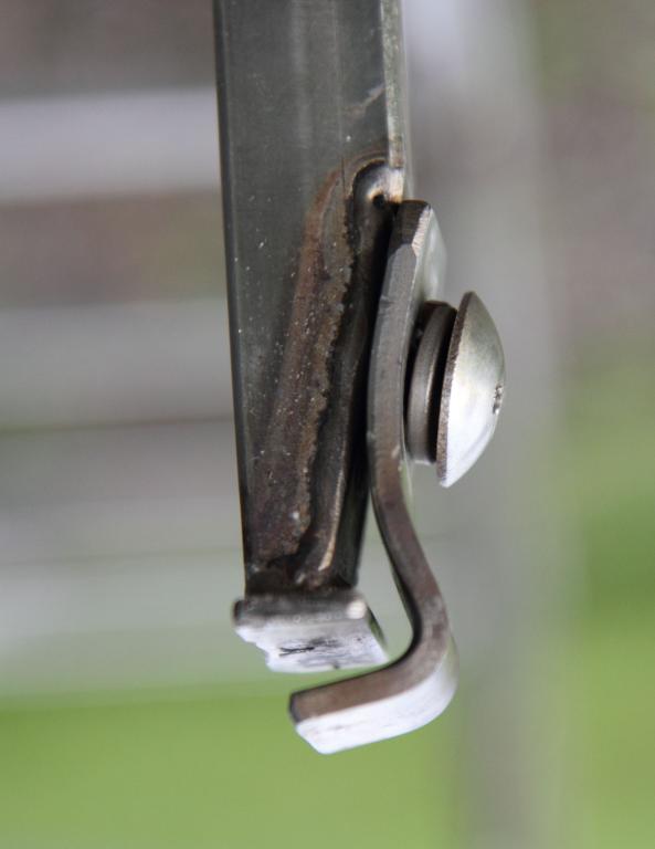

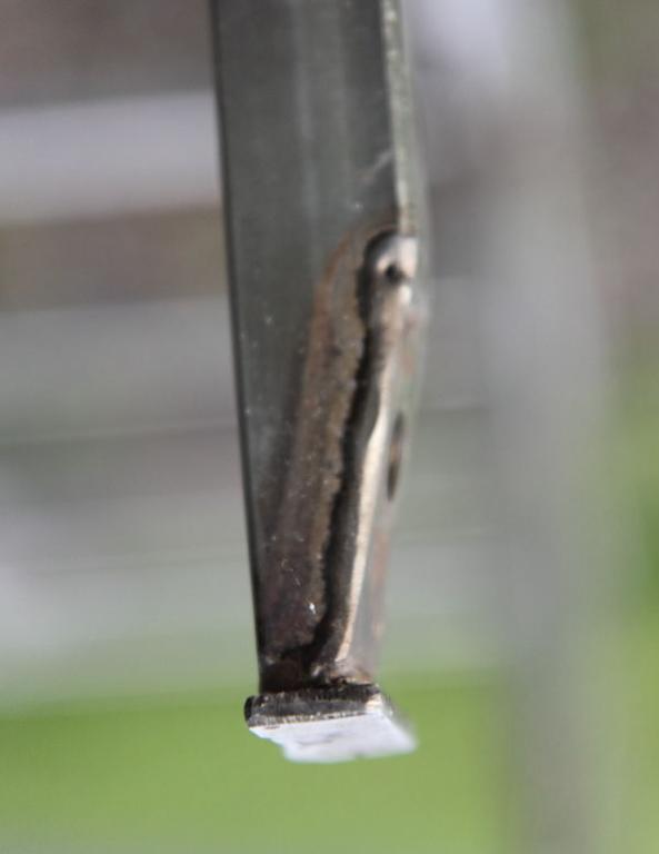

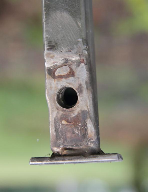

I'd modify it to some sort of clamp. Below are pics of how RN used to build their SS racks. Not sure if they still do this or not.
Foot side view:
Foot inline view:
Foot with clamp hardware:
I'm about a month away from actually installing this rack (roof rebuild not yet complete). so I' cannot say how well they work.Tom P.
