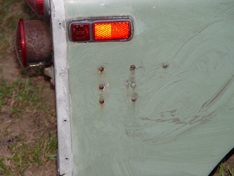

    Hello!
    I note that the paint is bubbling up around hammer rivets in my rear panels. This is on a 1973 Series 3 88".
    I presume this is the Birmabright reacting with the frame? Or might it be with the hammer rivets (are those steel or aluminum?).
    If I decide the paint this vehicle, is it as simple as sanding down flush, priming and painting? Or is there something I need to do to prevent future bubbling?
    Any ideas welcome!
    --Jason

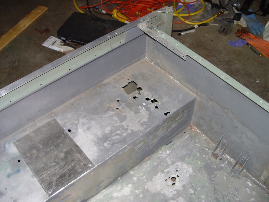

      On the quarter panels there is a row of rivets just below the capping (they are usually OK); then there are groups of rivets about mid way down that attach steel reinforcements for the rear seat belts (you can see them if you look in the wheel wells). I suspect that you are having the problem with this latter group. You are getting galvanic corrosion from steel and aluminum in contact, resulting in the aluminum slowly turning to powder.
      Here in Maine it is not uncommon to see S3's with big holes where the steel has eaten right through. A solution is to remove those steel reinforcements.

        That's the spot alright, on the rear quarter panels midway down.
        My Rover is at the shop right now, so I can't see close how things play together. But are you saying that these rivets are not structurally necessary? i.e. that those steel reinforcements could be removed without eventual damage to the panel?
        If so, I imagine they ARE important for the seat belts in the back.
        Sounds like MAYBE a route could be to remove the rivets, put a rubber pad between the steel and aluminum, and just bondo those holes and sand. Does that sound wise?
        Another option, I guess, would be replacing the rear quarter panels and making sure to pad between at that time.
        Do you know if the rivets themselves cause trouble? It looks like my hammer rivets are made of steel. Should all of those be replaced with pop rivets or aluminum hammer rivets (?) ultimately?
        Thank you sir!!!

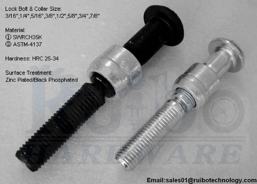

              They are lock and collars. A pneumatic gun presses them on and you can only remove them by drilling the head off or cutting the back out. If you decide to replace them, good luck on finding the brackets...and someone that has the pneumatic gun...well, I called within a 150 mile radius with no luck. Apparently, the car repair industry doesn't really do this anymore. Go figure...
              Here:
              And let me tell you...they will mess your tub up!

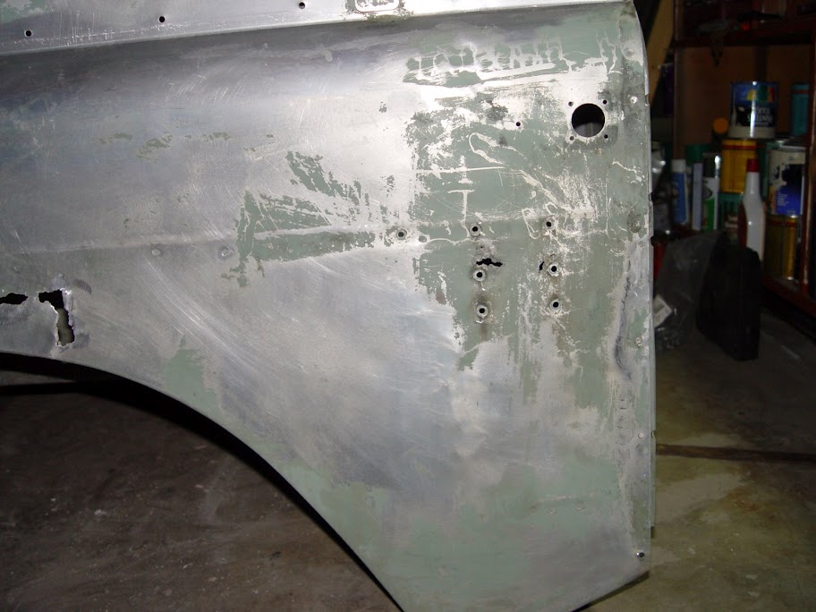

                  Although I don't have my Series III anymore (still keep an eye on the board though!), this is exactly the reason I removed those seatbelt mounts.
                  As I was replacing the quarter panels, I removed the old ones and then was able to slide the seatbelt mounting "bars" out (as well as on the left side an emissions canister) after removing all of the fasteners. I then replaced the quarter panels, which should eliminate that problem---for the new owner!
