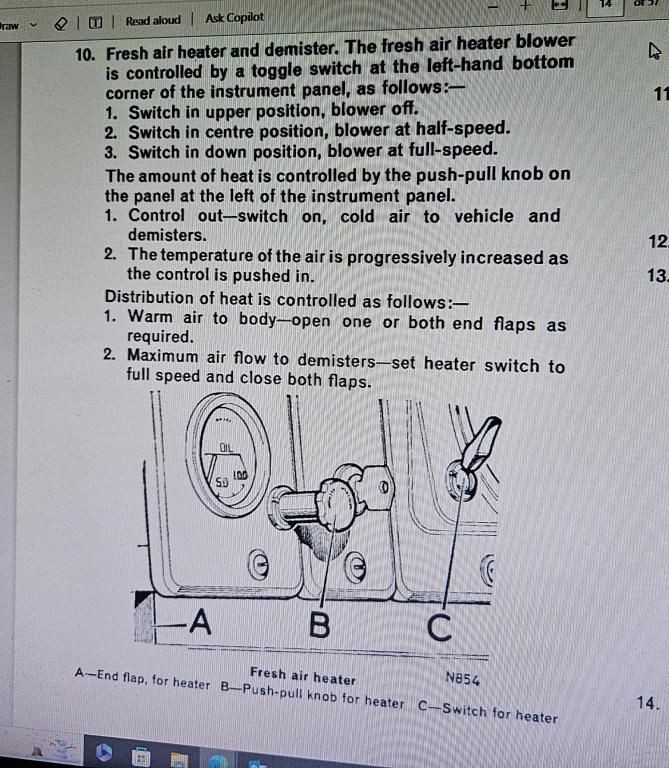

            I have just had a look at a copy of the operators manual for US vehicles with the fresh air heater and pushing the control in increases the heat output. Pull it out for cold air
