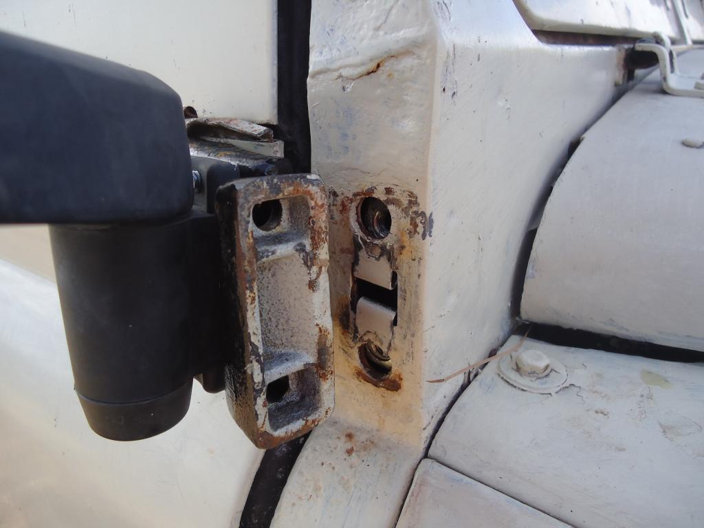

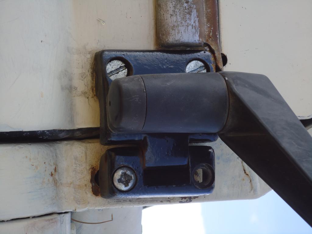

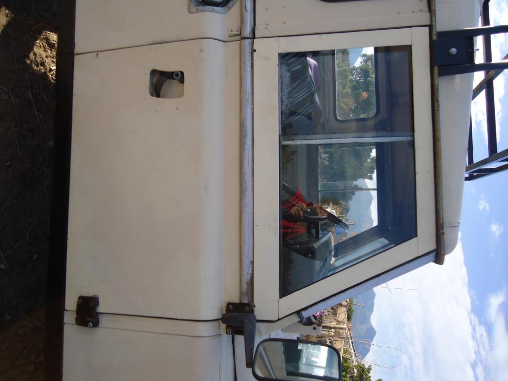

                  Here's what I have for you! Sorry about facing the wrong direction. I took free photos of the door in place, the hinges and also how when I take out the screws on the one, you can see it doesn't line up. I'm not keen on doing anything til i get more help from someone near by - he's had many Land Rovers and worked on them himself. I'll keep you posted,

                    Correct me if I'm wrong guys but these do not appear to be the correct hinges for the truck which would explain the poor fit.
                      I agree, looks like my wagon but not my hinges either.

                        #12
                        Hmm! They look like the kind you buy from Rovers North online for S3 doors. The driver's door works fine. It's just this passenger side that's screwy. Weird eh?!

                          #13
                          OK they are Defender hinges....all of them (at least the two in the pic) - not Series hinges. HOWEVER, they should work? Are they Proline or Original LandRover - that is the Q.
                          The thing is, I have them on my 109" - but only on top - for the mirror mounting...and yes - they line up perfectly. I suggest going one of two routes:
                          1. You source original Series III hinges and see if that fixes it
                          2. You buy two new ones ~$28 + shipping from RoversNorth and see if newer ones help - just don't paint them before mounting/checking - if they dont work you MAY be able to return them (check first )

                            #14
                            I was under the impression that the defender hinges should work but I believe there are different hinges for the front doors and middle doors. Is there any chance the bottom hinge got mixed-up with one of the middle door hinges?

                              #15
                              Okay! So I have the answer! Thom and I took a good few hours working it out but here goes. After comparing to his military 1971 we noticed that the hinges were mixed up, as in we needed to take off the bottom hinges off each door and switch them out. Then we finally noticed that the doors have been modified, so the cross pieces were a bigger dimension than the original. The welder had not measured well and they were 3/8 inch too wide to sit in the frame and open without rubbing.
                              I'll need to get the doors replaced or to grind off that extra 3/8 in of metal across the bottom.
