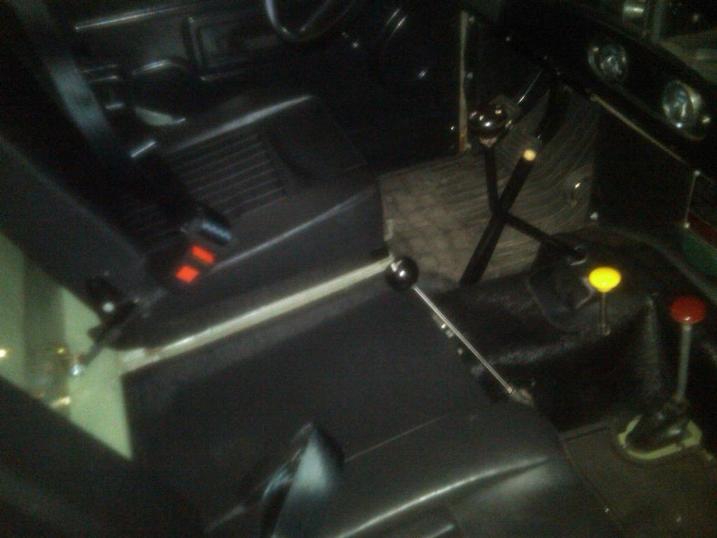

            The only real kink we ran into was that the shift lever and knob foul the center seat w/ OD disengaged. We tried adjusting the actuating rod but that just moves the throw arc and there isn't much room on either end. See the pic, this is with the OD disengaged and shift lever in 2nd. This leaves about 1/2"+, a little more than a knuckle, between the OD knob and the shift lever in 4th. You could bend the OD lever outboard and up to gain more clearance, but that would also lower the knob. I could also try a straight lever to get more clearance to move the arc forward, but I don't see that much utility in the middle seat and the OD lever is perfectly located for me now. I removed my middle seat and cut in some rubber matting.

              Seconding the gear lever issue. Mine got in the way of 4th and reverse when engaged. I had my HS shop teacher heat it and put about a 15 degree bend in it, so when screwed in it hugs the top of the tunnel a bit more closely and doesn't get in the way of the main gear lever.
