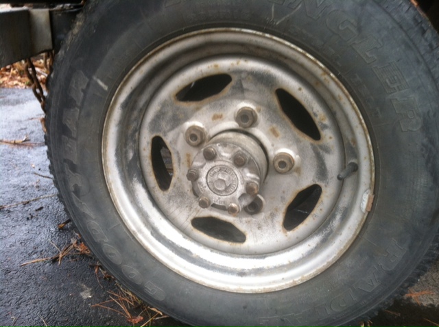

    So I just sorted over 13 pages trying to learn about wheel color. I have a 1970 IIA and Limestone seems to be the color. How ever all the pics I found were of a differnt style wheel then I have. My current wheel is a faded silver with touches of black. Not sure which is the top coat, black or silver. Is limestone the approporate color for this style wheel?

    Looks like a Discovery 1, steel spare wheel. I believe these were silver from the factory, but they're 20+ years younger than your IIa! I would paint them whatever color strikes your fancy or matches your color scheme - limestone, body-color, or black.
    Tom P.

      The disco steels were a popular look in the 1990s, so lots of trucks have them.

        Disco wheels, guess thats why they didn't come up in my series search. I've got 4 on the truck and a matching spare. Thanks for the info. I like them, they look heavy duty. 16x7

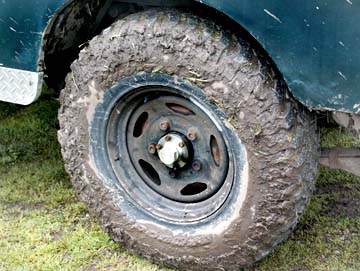

          They are indeed Discovery I wheels which are the widest Land Rover factory wheels that will fit a Series truck. I've had a set under my 109 since around 1996 when a LR dealer made me an offer I could not refuse on a set of take offs that were shipped to the dealer under a new D90. The silver colour was Rover's idea of matching the colour of the alloys that shipped with US spec Discovery I trucks.
          If you have a limestone truck you might consider painting them limestone as that was the wheel colour that came with limestone Series trucks.
          For power coating wheels, a very close match to Limestone is powder code # RAL 1015. For hardware store rattle cans, "antique white" and Rustoleum Almond is about as close as you will find.
          My 109 is British Racing Green and I have semi gloss black powder coated Disco I wheels under her.
