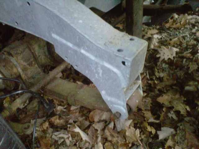

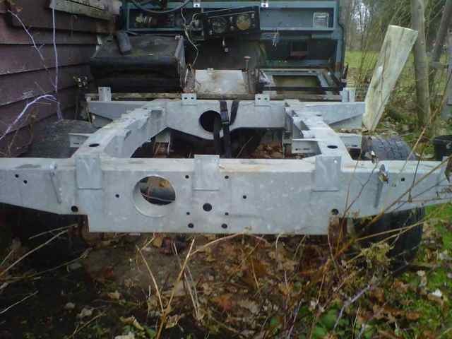

              Here's some pics of the chassis for sale...Click image for larger version
              What do you guys think?

                I'm guessing it's a Marsland.
                Jason
                "Clubs are for Chumps" Club president

                  Mine was stamped marsland on the top face of both bulkhead outriggers.

                    That's a good one ill have to get a pic o that area to confirm
