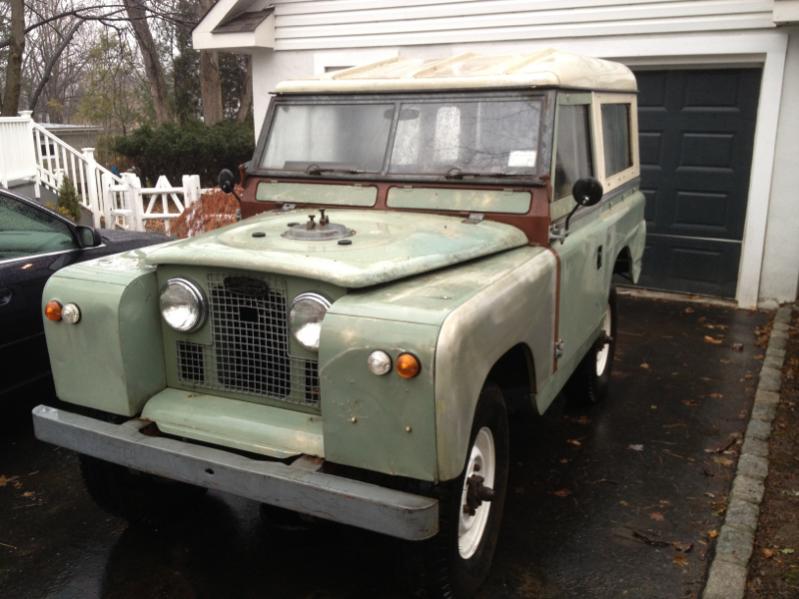

    Hello All, I have just recently picked up a 1966 Series IIa named Olive ... The truck has switched hands a few times over the past years in the NJ area, but hasnt really been on the road in about 4 years or so, and not sure of the history before that.

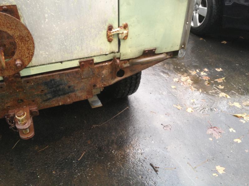

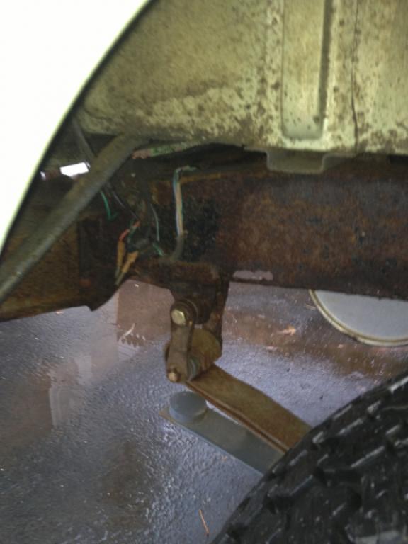

    The truck runs pretty well actually, the previous owners have rebuilt the entire fuel system, and also added parabolic springs & OME shocks. Overall though, the truck ain't pretty... the frame has a hole near the rear spring mount, and the rear cross member is ugly... but I went over the whole frame with a hammer, and those seem to be the only rough/soft spots.

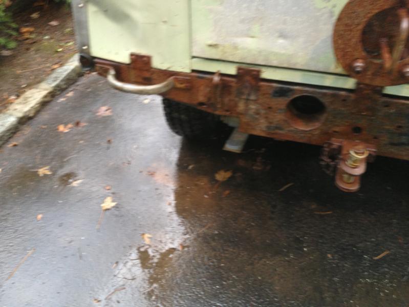

ID:	171356Click image for larger version
    Now... I have a galvanized chassis that came with the truck.. I'm debating if I should replace the whole chassis or just do the rear crossmember... I'm worried about getting a case of shipfitters disease and not get it done for a couple of years.
    Anyways -- I do have a specific question -- In looking at the picture of the frame near the rear spring mount, would the rovers north Rear Crossmember w/ 18" (RNE404) be adequate for that? Does it have the replacement leaf spring mount already on it? Doing a quick measurement yesterday, it looks like the rust goes to about 12/13" from the rear crossmember.

    In pic #4 there is what appears to be a pretty significant body/frame issue. Looks like the tub is jacked and the crossmember is bent. I would strongly urge you to consider the frame swap since you have it on hand. Thing is that installing the weld in crossmember is almost as much hell as doing a frame swap, if you do it properly that is.
    A frame swap will definitely reveal problems. I would budget about $5000 in funds and then a whole ton of weekends.
