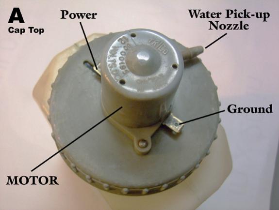

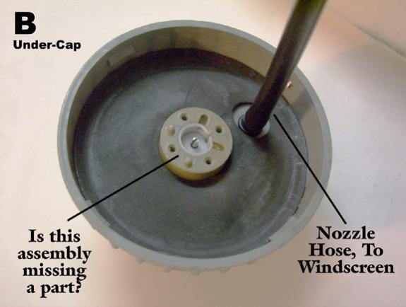

    Thanks for your response to my earlier questions regarding my 40-year old Trico Washer Assembly - the one with something (?) missing. Here's the pics I intended to include last time, but my questions out-ran my organizational discipline.
    What in the heck is my assembly missing? Anyone got pics of the real thing?
    Thanks again for any assistance.
    David

      you are missing the impeller, impeller drive, and cover

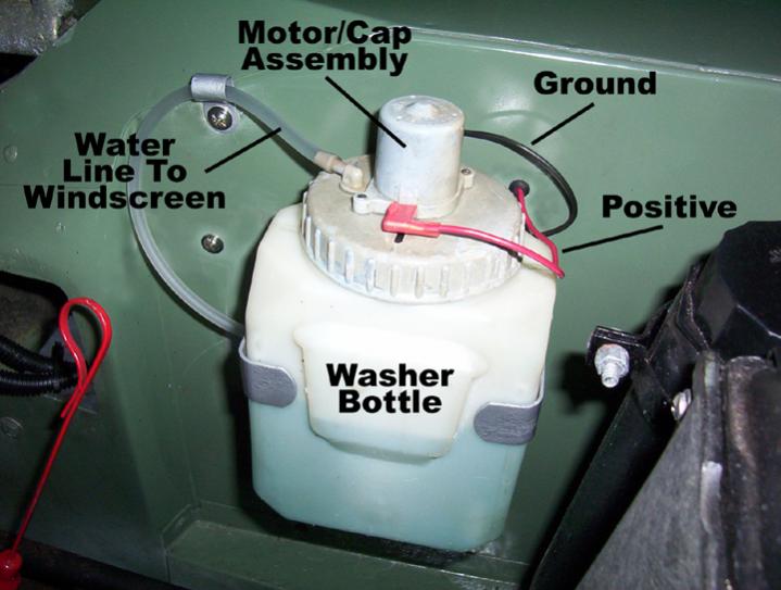

          The vintage Trico Washer Assembly is self-contained. This is my first encounter with one. And my assembly, I discovered, is missing some major parts, as pointed out by others!
          Below is a photo of my Trico Assembly recently installed in my '71 2a. As you can see, the water bottle is actually an integral part of the system. Water is pumped from its own bottle. And the cap-unit easily screws off to allow for quick refills.
          TRICK INSTALLATION:
          My assembly, as seen here, does not actually function - especially without its pumping "mechanisms" inside the cap. So, I just installed a separate Trico pump on the underside of the fender. The stainless steel screw head - showing on the left side of the bottle - is one of the screws used to mount the new Trico pump onto the flip side of the fender. The red power wire you see here is fake. It's there just for looks; same with the black ground wire. The supply hose is a different story though. My new under-fender Trico pump uses the original Trico bottle for its water, so the supply hose you see runs through a hole behind the bottle, through a rubber grommit of course, and attaches to the new (hidden) Trico pump!
          It works fine. Now I just have to install my original alloy washer nozzles. The aftermarket plastic nozzles I'm using now are not "angled" so that the water squirts AT the windscreen and not OVER the windscreen! Right now, my plastic nozzles squirt water past the windscreen and onto my soft-top! Oh well. When you own a Series Rover, it's Never Over.

            Some washer nozzles are adjustable. Stick a pin in the opening where the fluid squirts out and you may be able to "aim" the nozzle by pushing the pin towards the windshield. Sometimes it is just a ball in a socket so you can rotate it to where it needs to spray.

              That makes sense! When I examined my original nozzles, the actual "ball-shaped" nozzles were definately "angled" slightly. Now I'll take a closer look at my plastic after-market nozzles - under a light - and see if they can be rotated! I should have checked them out before. Thanks for the help. The more I utillze this Forum thing, the more I start to think I'm getting smarter? NOT!

                Got 'em aimed. You're a genius. I put a small amount of 3-in-1 oil on each of the tiny ball-shaped nozzles, and then used a pin to aim each nozzle back toward the windscreen. Perfect. Thanks!
