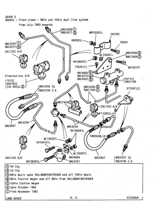

      This is from the parts manual. It isn't exactly what you want but I think you can extrapolate the route pretty well from it.The pipes shown in the UL corner come from the master cylinder and go into the shuttle valve pictured right center. Front pipe goes to three-way T, and then to each side. Rear pipe goes to flexible hose that mounts on frame. The flexible hose goes to axle-mounted T fitting and then to each side.
      If you are running a new system, you can probably safely delete the shuttle valve. I put in a Wilwood adjustable proportioning valve instead. I ran the front pipe directly to the T fitting.

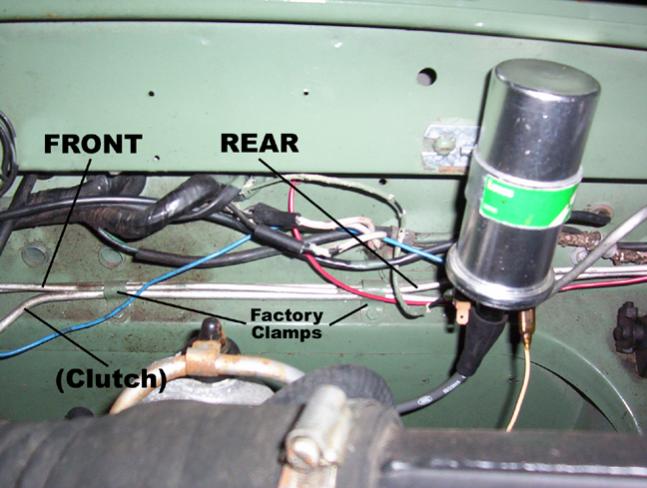

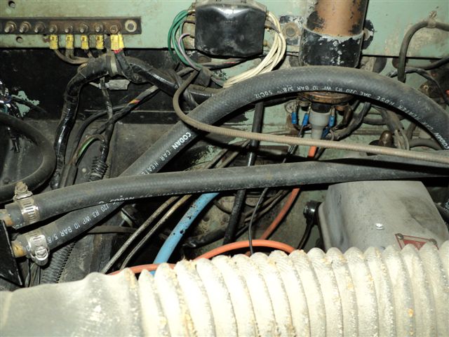

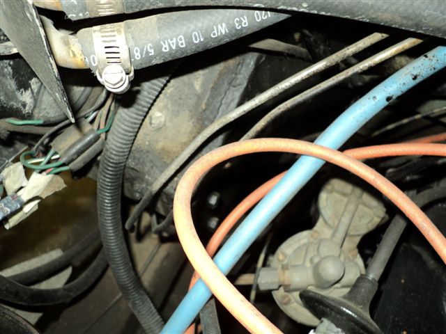

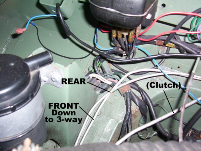

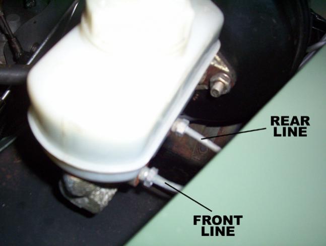

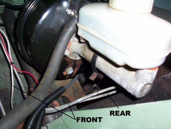

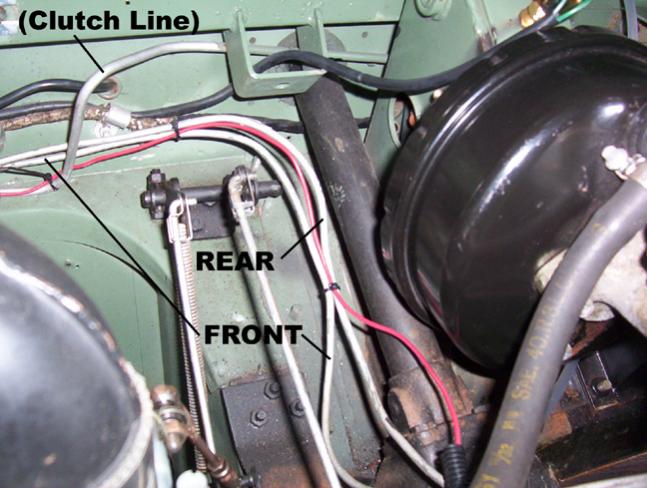

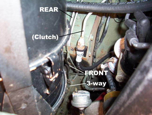

                      Brake Line Photos, Dual MC, 88
                      Here's a few pics of the brake line route on my '71.
                      Pay no attention to the unplugged wire above my oil pressure sending unit. My sending unit developed a short - causing the guage to read "full on". I'm switching to a mechanical system soon. The sending unit wire was renewed, but I do believe the short is in the actual sending unit.

                        Oh...I just noticed that there is a third factory "loop-style" clamp just above the 3-way connector, holding the two brake lines. The other two clamps (on the bulkhead) are holding the clutch along with the brake lines. Details, details...

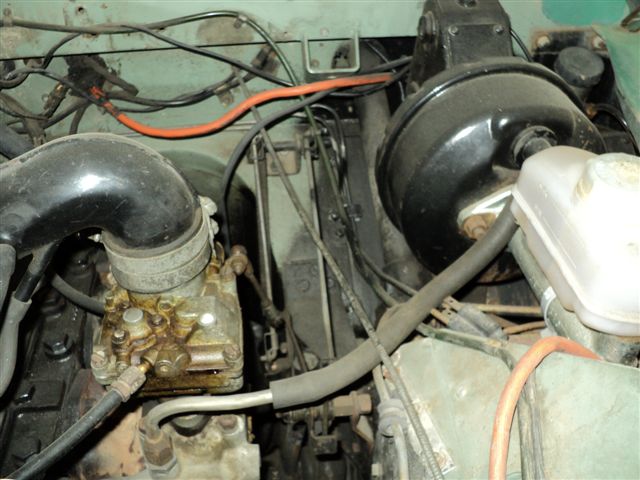

                              #15
                              Here's my '73:
                              © 1974 Apis Mellifera. Few rights preserved.
