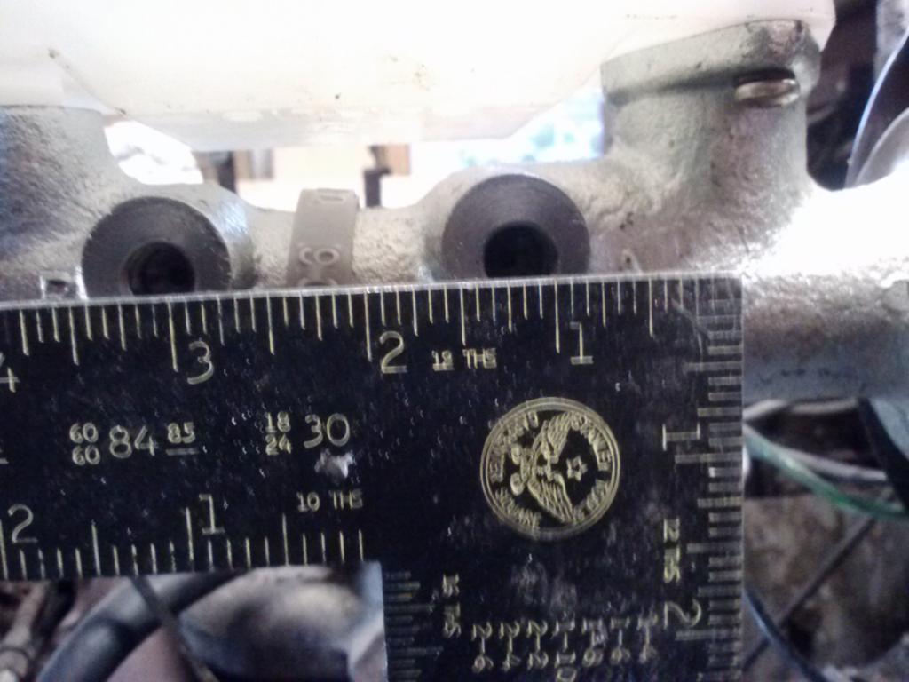

I took a look at your pictures. None of them are a eye level profile of the body but it looks to me like you are installing an 88 master cylinder. If you look at the master cylinder pictures I have about half way down the web page you can see the differences. The 88 brake cylinder body is a constant diameter when viewed from profile. The 109 master cylinder when viewed from the side is taller for the half of the cylinder body closest to the servo unit then about half way down its length steps down. This is the diagnostic visible difference between the two types. Look at my pictures then look at your master cylinder. It should become obvious.

I took another look from the side and the casting does change in diameter (see pic) and consistent with their pics the diameter of the rear port is larger (~7/16") than that of the front port (~3/8") so it seems it is a 109MC. So I think I got the right MC for my conversion. However when I was looking at the series III shop manual on how to run the lines I noticed the manual contradicts your web site as to what axle goes to what port. The manual says on a 109 dual MC the rear port goes to the rear wheels and the front port goes to the front wheels and that it is the opposite on the 88 MC. Understand your logic about needing more volume for the front brakes but could it be possible that the fitting diameter does not correlate to bore volume displacement?
Can anyone tell me how the fluid flows inside the MC bore when it is stroked?SIII WS manual Brakes.pdf
