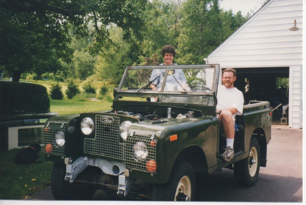

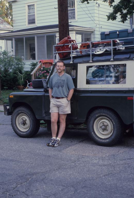

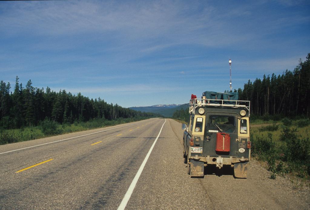

    1 & 2 Us before departing, with the truck loaded
    3. Ferry crossing Lake Champlain. (We left from Wiscasset, ME on June 30, 2000, headed across to Burlington, VT, then across NY and into Canada, crossing above the Great Lakes. Our intent was to travel the AlCan highway to Alaska, get up as for north as we could on the Dalton Highway, then turn around and head down the west coast of the Americas in the system of highways called the Pan-American.)

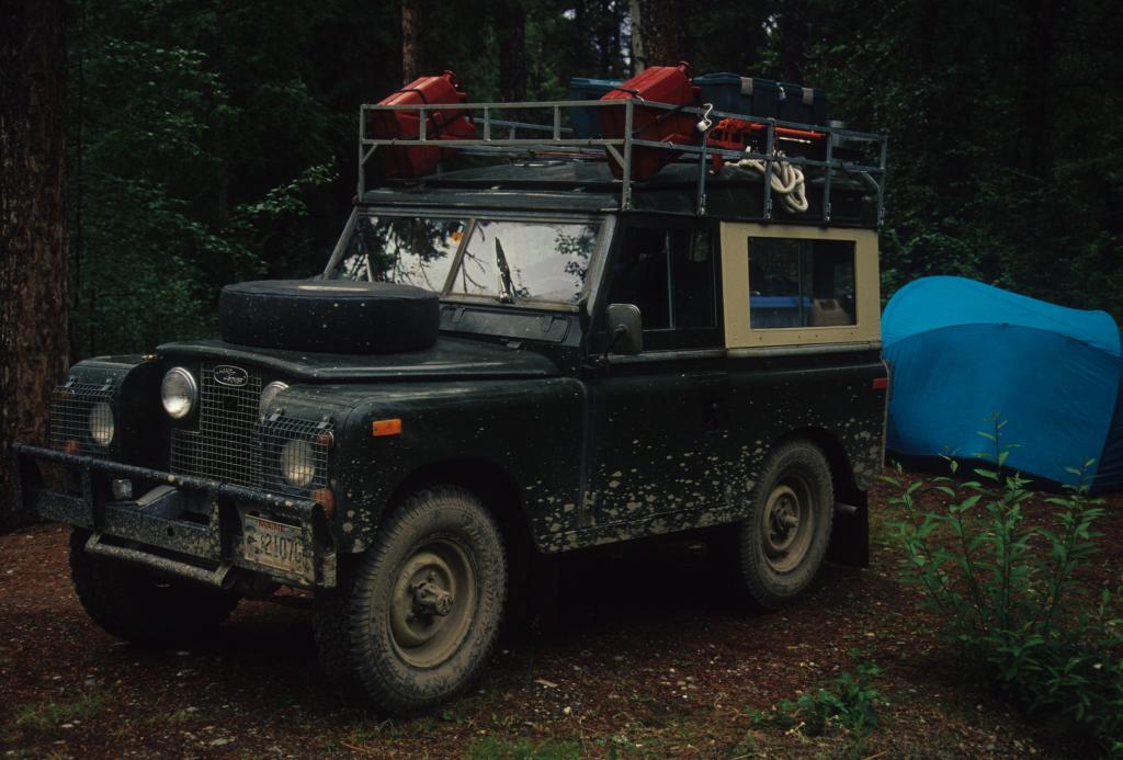

    4&5 Wildlife in Alaska and Canada.

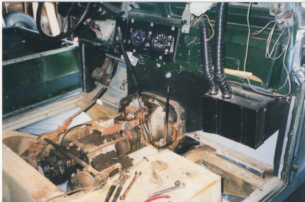

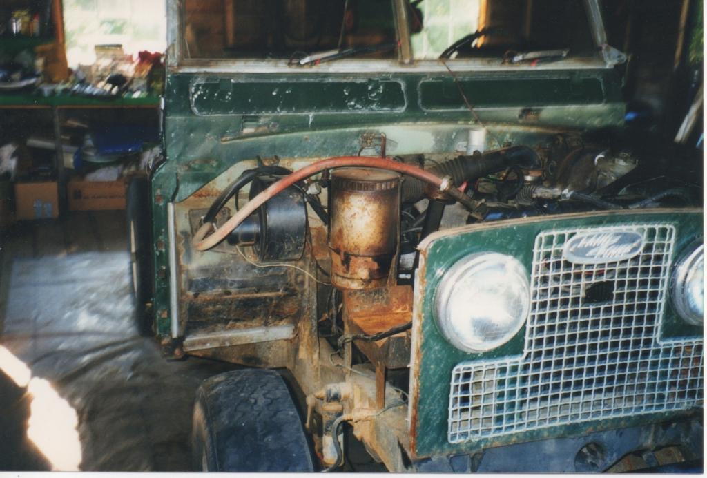

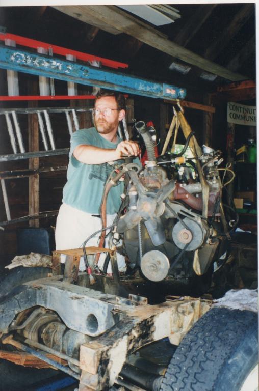

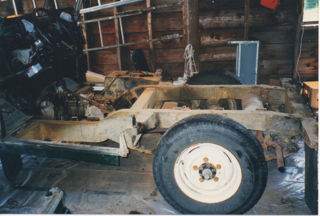

          We parked the truck in my dad's garage in June of 1999 and started dismantling. Most stuff comes apart fairly readily. I had done a new transmission and clutch before and numerous brake/hub seal jobs, so I felt like I could tackle it. We did resort to a Sawzall a few times to cut spring bolts and used lots of PB blaster and WD-40, as well as a 6 foot section of pipe that we nicknamed "The Torque Multiplier" or "Senor Torquemada." A few sticky bolts would give a loud squeal when they finally surrendered to Senor Torquemada.
          More shots of the tear-down:

          We put in new front springs. I had replaced the rears a couple of years before (in a crippling 14-hour session of trying to turn the shackle bolts) so I didn't think they needed to be changed, but it turned out with the additional load the Rover would be carrying, the rear end would settle down pretty far. We were dragging our tail a lot during that trip. Of course, we overpacked, but I can discuss the packing rationale later.

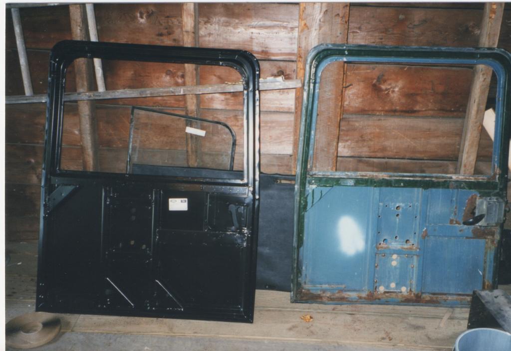

          We replaced the rear door (and last summer I replaced that door yet again - frame rust) and I fooled around over the following year with getting a custom-drilled piece of rear glass that I could mount a wiper motor in, but that glass cracked pretty soon and it just stayed cracked for years until a I gave up on that and put in plain glass and a wiper mounted in the upper frame, above the window. I loves me some clear windows. I also have fussed with rear-window defrosters and never had any luck getting them to work, so right now my rear glass is just plain and I am super cautious on cold rainy days when the windows fog.
          The day the truck arrived with the galvanized frame was exciting. I was leery of how to move it but it turned out the truck driver, my dad and I managed to just carry it into the garage on set it against the wall. I should have done more to clear the bolt holes of zinc, but I only learned of that later. I did spray it all over with Ospho, a phosphoric acid solution that bonds with iron to create iron phosphate, an inert rust-resistant shell. Any dings in the galvanizing I hoped to fill with this to stave off corrosion.
          We sold the old frame to a kid who actually drove down from Nova Scotia to collect it in a big pick up truck. The frame wasn't in bad shape; lots of oil all over it of course. The transmission cross member was banged up from some ancient off-roading incident before I owned it. He seemed happy to have it, so we got it all loaded up and tied and down and wished him well.

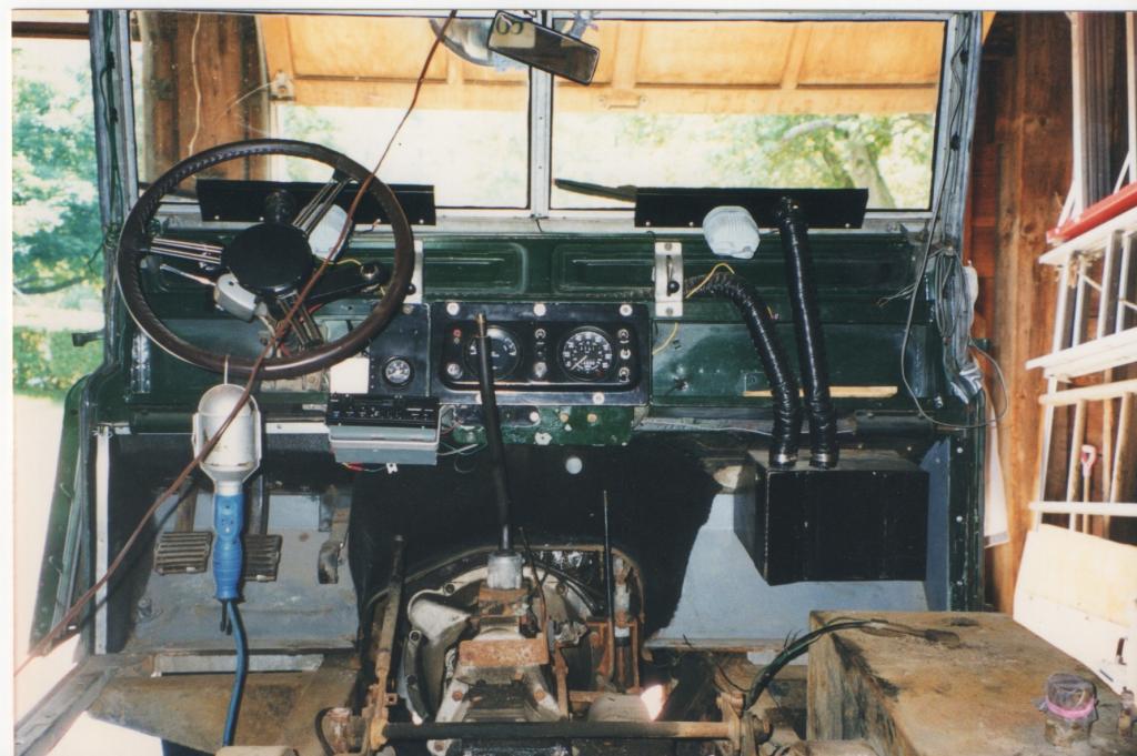

            We got the truck more or less back together. There were some mishaps, mostly due to my ignorance of electrical issues such as when I burned up several sets of points because the high tension lead from the coil bypassed the coil altogether, so the full battery current was running through the points on the distributor. But once I sorted that out, it actually started up fairly easily after 6 weeks of being torn to pieces.
            At that point though, I realized that I hadn't wired the instruments and lights back together properly so I ended up having it towed to a local garage and a mechanic put in a bunch of new wiring and got it more or less running. This took a few weeks; we returned home and I had to go get the truck a few weeks later. This was all the year before the trip so I had anticipated having a long shakedown period.

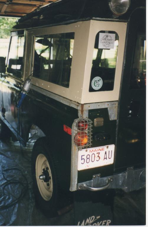

            We repainted the truck (just with a brush) in Rover Bronze Green with Limestone wheels and top. The brush painting is a bit ghetto, but since I don't have too many vanities the appearance of the truck, it worked out fine. (I've brush painted it several times since then.) The previous color was something called "Cameroon Green" which had more of a bluish cast to it, so once we started repainting one part, we had to do the whole thing.

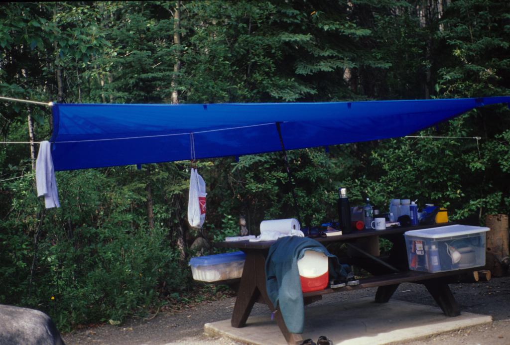

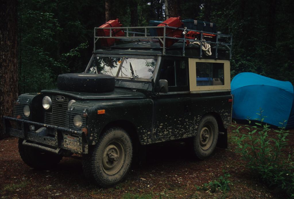

                          Update: Some camping pictures. We generally were car camping of course so we could carry whatever food we wanted. We had a small cooler (as I recall) but of course we did not always have ice for it, etc., but it was handy. We usually pitched our tarp over the cooking area.

                          These are mostly sites in Canada and Alaska. We had a few memorable episodes with the voracious mosquito populations you sometimes encounter up north- in one primitive provincial campsite in British Columbia we we warmed by the worst mosquitoes I have ever seen and after hastily cooking something and eating we jumped into the tent at about 6:00. You could then hear the general hum of thousands of mosquitoes lighting on the tent. It made me think of the early travelers and Indians in these areas, for whom this was a daily fact of life.

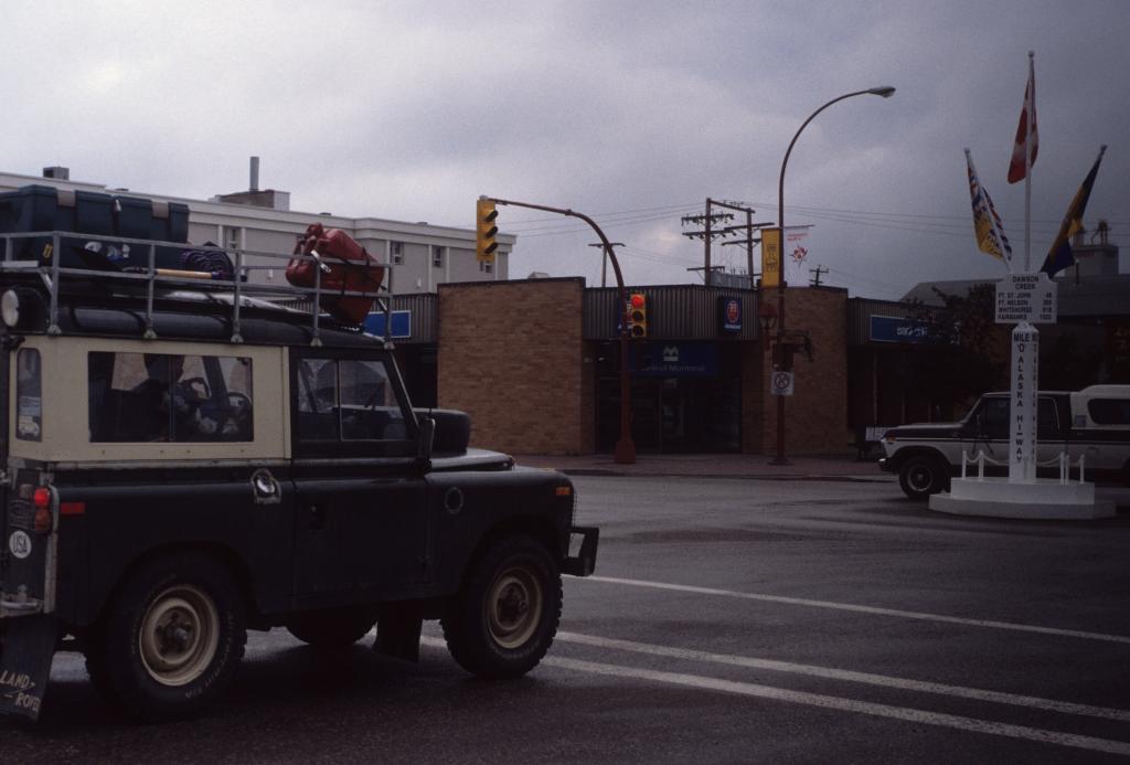

                              Starting the Alaska highway in Dawson, BC.
                              I don't have a lot of strong memories of crossing Canada- it was nice, friendly people and so forth, but it was about two weeks of sameness and low-quality coffee. The great plains area of the US extends up into the Canadian prairies so there long stretches of uninterrupted flat land. We were also sort of fighting the westerly headwinds much of the time so we were sometimes slowed to about 45 miles an hour ,despite the overdrive. We would try to get in the baffles of big trucks sometimes to travel in their slipstream, but that was sort of dangerous. Mechanical problems: just my perennial weak brakes, that always take a couple of pumps no matter how much adjusting I did. (I solved this problem many years later, just last summer in fact, and for the first time I have decent brakes. It turned out that my right front backing plate had a lower pin broken loose, so the shoes were sort of floating on a moving pin, so you could never fully adjust to take up the slack in the system. I found a replacement and put that in, along with new drums and pads, and a little machining later - presto, proper brakes. I can't believe I lived with it for 15 years.)
                              We crossed into BC and got onto the real Alaska highway which is mostly gravel out that way, although they were in the process of paving it and I imagine it's all done now. It was built originally during WWII to allow military materiel to be moved more quickly to Alaska in case of a Japanese attack on that territory. It has been continually upgraded. Traveling in some traffic there was the first time I had really encountered a bad dust problem. We ended up closing all the windows despite the summer weather, then trying to open them all to create a draft to keep the dust out, etc. Not successful. It was here too we got hit with a flying piece of gravel that put a small hole in our radiator, and we learned by it is all the trucks have fine screens in front of their radiators on these gravel highways. I got a section of screen at a hardware store and wired it to the back of my grill to keep stones out, but too late. (It's still there, in fact.) Because of this gradual seeping of coolant, we spent several days topping it up every morning and trying all manner of tricks such as pouring pepper into the radiator to create sort of a plug and also using some of that aluminized power that purports to do the same thing. None of it entirely successful. One thing I find noteworthy is that the Rover will continue running even if some systems are not working 100%. In a modern car, if one module or sensor goes, sometimes the whole thing can be immobilized. (On the other hand, no A/C in the Rover!)
