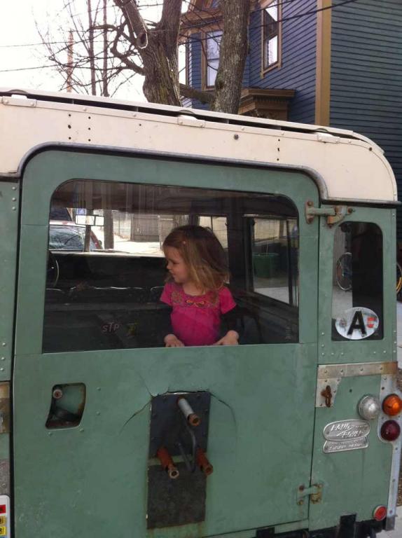

              #7
              My door is shredded from the weight and bouncing of the tire over bumps.

                #8
                Originally posted by Wolf323i
                [ATTACH]7834[/ATTACH]
                That's exactly why the inner frame needs to be reinforced and the tire carrier needs to be mounted to that in a manner that spreads the load out. You can see that someone moved the mount from the original lower location. They probably did nothing other than move it up and that's exactly what will happen.

                  #9
                  Thanks much. Exactly what I needed. I was worried about metal fatigue on the door and the picture clears shows it. Wow. I have bigger bfg tires and one on the bonnet. I think I will keep it there. Anyone done anything creative with the rear mount without a tire?
