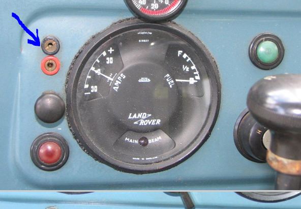

The red plug is hot and the black plug is the ground. LR once made accessories that plugged into the dash, like a work light and they even made an electric tea pot that plugged into it. I purchased the two prong adaptor and use it for my phone charger, a fan, and when off road I plug in my CB radio.'73 Series III 88 2.25l Petrol, '06 LR3, '08 Range Rover Sport Supercharged

I think you may be missing something here, this is a 12v DC connection, not an AC connection.Comment

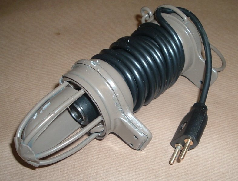

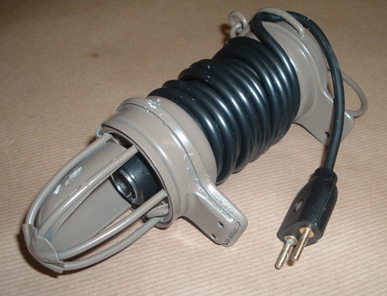

I have the work lamp shown in the photo (very handy and durable, by the way), and when I use it I've noticed that the dash plugs heat up. Do you have this problem? Just curious. I'm sure that it has nothing to do with the fact that the wiring will be 43 years old in March....

The 12v sockets are cool, in an original oddball rover way, but having 12V right there, open to shorting out the 40+ yr old wiring on anything just freaks me out. I disconnected the wiring behind the red one and installed a nice fused cig lighter outlet in the side of my blank dash panel. Now I know its capacity, and have lots of things available to use it with.

Ted, I'm thinking that if the plugs are heating up in use then you are drawing way too much current. So you have the wrong bulb in your light, or something. If any part of your electrical system is getting hot then please please find the problem and fix it. The plugs are relatively big and heavy, imagine the wire behind them would be getting really hot!!

These work lights are / were military issue - perhaps I have a 24V bulb in it? Could that be the problem?Ted, I'm thinking that if the plugs are heating up in use then you are drawing way too much current. So you have the wrong bulb in your light, or something. If any part of your electrical system is getting hot then please please find the problem and fix it. The plugs are relatively big and heavy, imagine the wire behind them would be getting really hot!!
