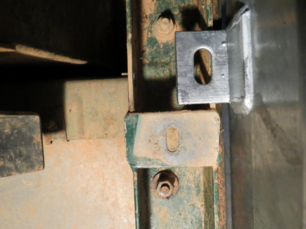

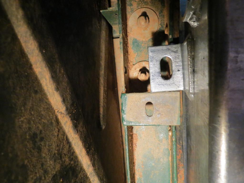

There has been some discussion of the installation of the rovers north rock sliders needing some custom fitting to the series Rovers. Here are some pictures of the issue that I am dealing with (that the tabs on the sliders do not line up with the sill channel tabs). I am wondering of other have faced the same problem and would describe or post pics of the solution that they cam up with to help me and other in the future. Thanks to anyone that can help!

Now that's off just a smidge now isn't it?! Are these supposed to be for series trucks or are they for a D90 that you're trying to make work on a series truck?Jason

I think (don't quote me) there's normally an "L"-shaped piece between the sill and the floor support piece here on my 109. I'll check the parts catalogue...--Mark

I am in the process of making some plates just like Mark suggested. These are the series sliders according to R.N., not the defender sliders. I guess that there must be come variation as to the location of the sill tabs on different year models, or whoever made the sliders had a measuring error. They do attach to the front and rear outriggers, so at these tabs are secondary support.Comment

I have called and emailed pics. They said they would look into it and call me back, but still haven't heard anything. I ended up making some plates similar to the picture that mark posted. The sliders are pretty darn solid primarily from the outrigger mounting points. These tabs seem somewhat secondary, so I am satisfied with the fix.Comment
The current Rock Sliders RN offers are built for the Series III 88" or 109".
There is, as seen here, a variance between the Series IIa and Series III centre mount.
As this is not a main support, the main mounts are at the bulkhead and mid outrigger points.
It would easy enough to fab. a flat plate as shown above, if it is felt that this support is needed.
