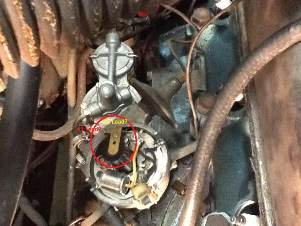

                    I ordered some new leads from our sponsors just in case. The old ones looked, well, old. When the new leads come in, I'll check for the spark. I'll try some gas in the intake in a few days. I'm still paranoid about the location of number 1 on the distributor cap. I aligned the timing tick mark with the pulley with the manual crankshaft. What I can't figure out is this: There is a brass fitting on the top of my rotor arm with an arrow that points counterclockwise. Is the location of the number 1 where that arrow points or is the location of the number one where the straight portion of the brass top is pointing? I attached a picture to see if anyone can point that out to me, if this makes sense.Click image for larger version
Name:	Little Pooter 4 003.jpg
                    Although not clear, the arrow is pointing towards the red writing.

                      I don't have a distributor on my engine, so I have nothing to compare it to, but something looks odd about the orientation of your distributor and especially the rotor if it is shown pointing to #1 TDC on the compression stroke. IIRC, most of the distributors I've seen have the supply line to the vacuum advance pointing directly aft and the lead to the primary circuit entering the distributor housing directly between the distributor and engine block.
                      For example:
                      I'm sure that a dozen other people who burn gasoline can confirm/refute this or determine whether it's relevant/related or not.
                      Is the vacuum line at the advance mechanism kinked? Hard to tell by the pic, but in that orientation, I imagine it'd have to be...
                      OH...and I believe that the arrow just indicates direction of rotation, so the leading edge (where your red writing is) should be the first part of the rotor to go past the terminals on the underside of the distributor cap.

                          TDC occurs in two spots, the compression stroke and the exhaust stroke, I mentioned earlier that it must be TDC on the compression stroke. THIS is where the #1 plug lead should go where the rotor is at that point. To determine TDC on the compression stroke remove the #1 plug and place your thumb or finger over the hole while bringing the engine to TDC, you will feel the pressure releasing. It is possible to install the distributor 180 deg out and from your picture that is what is wrong.

                            You're really close to getting her running just right. The timing sounds a little retarded to me in the video and the pop may be coming from the leads being switched or a faulty lead.
                            The dist. rotor arm should be pointing to the lead for cylinder 1 at TDC (not the arrow but the middle of the brass fitting should be in line with the contact for cyl 1). If you manually set the timing by rotating the engine and lining the marks up on the engine, make sure the rotor is pointing at the lead for the #1 cylinder (theres a 50% chance that its pointing at #1) before rotating the distributor and setting the timing. On my distributor cylinder 1 lead is at about 2 o'clock (standing on the passenger side). The wires go 1-2-4-3 clockwise around the distributor. Hope this helps, i've gotta go back to troubleshooting my starter, fingers crossed its only a bad electrical connection. I like the nickname for yours... i'm about to call mine "big dump" if things don't start going better soon

                              I see what you're saying about the distributor orientation based on the two pix. The vic came this way when purchased. Is it something that I need to take off and realign?

                                While you can position the #1 plug lead almost anywhere by juggling the leads around and rotating the distributor, my concern and that I suspect of Safeairone is that the vacuum advance might be pinched off. It might also be that because the vacuum advance is contacting the engine it might not be possible to time the engine correctly because of not being able to rotate the distributor enough.
