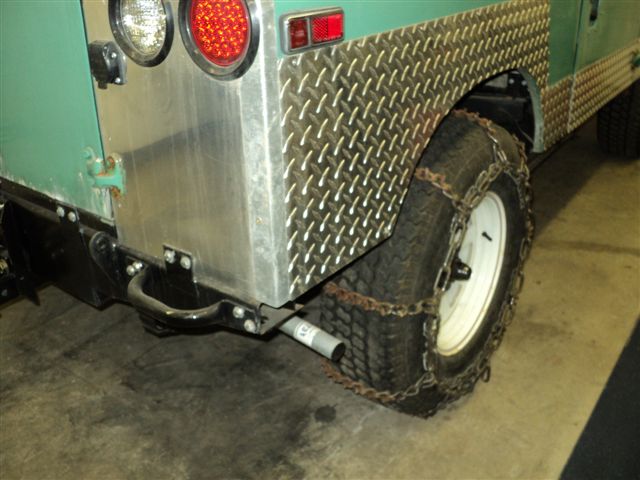

To over come the small brake and tail lights along with the poor backup lights I installed 4 inch LED combo stop/turn/tail and 4 inch 55watt floods. I went with the combo lights because I also wired a trailer tow plug with electric brakes at the same time. You could actually use a 4 inch red and a 4 inch amber if you wanted to keep the independent turn signals. Not a very good pic of the lights as it was supposed to show the tire chains but you get the idea.
1971 series 2a 88, series 3 trans, Fairey OD, owned since 1978. -

Thanks, and I know it's not everyone's cupa tea that's why I showed a picture. I wanted reliability first, size second, I don't know how others feel but it seems the Landrover doesn't get respect from other drivers, I used to almost get rear ended lots I even installed another set of rear lights mounted to the hard top but when the top is off you lose the extra lights. Going with these 4 inchers solved the problems I was looking to cure and they can be bought almost anywhere in a pinch.1971 series 2a 88, series 3 trans, Fairey OD, owned since 1978.Comment

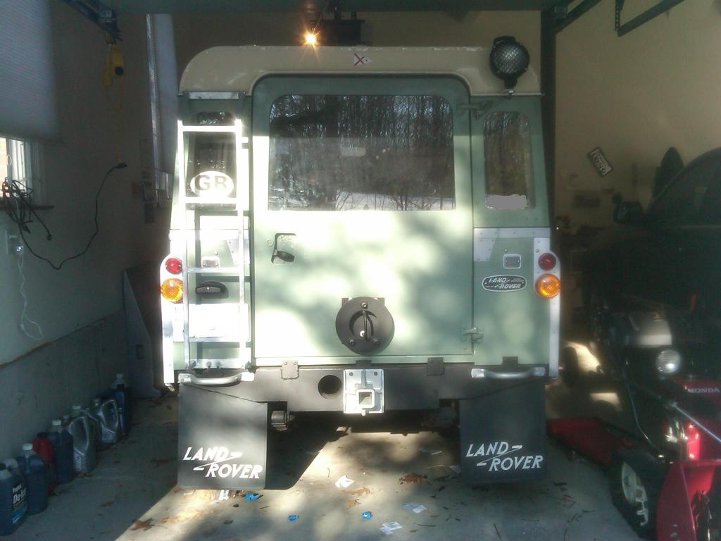

I like the idea of bigger stop lights and, if you want to keep close to original, bright led bulbs in the NAS Defender round units are a good combo. Here is mine w/ the NAS Defender signals, I may yet get red lenses and use them for tail/stop:
