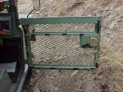

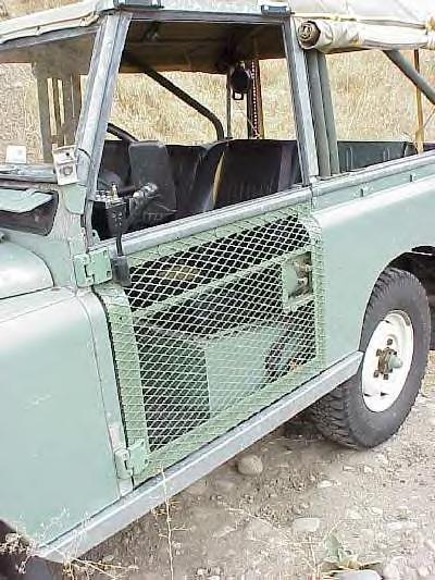

    I'm looking for a couple door frames for cheap(read that as free) to make a couple of summer doors. I remember from my first Land Rover, how hot these things can get in the summer. I'm hoping to find them somewhere in or near Massachusetts. PM me if you have some, they don't have to be in great condition, just servicable, I can weld and do have so stock on hand.

    No extra doors, but that is one neat mod.

      Yeah it is, I really like it, and think it would be great for the summer time. Kind of a compromise between taking the doors off to stay cool, and safety.

                As you don't have to worry about the door sealing tight why not just fabricate some frames from square tube, that's what I plan to do, by the way love those doors.
                  I like them too, they should work great for summer heat. That would have been fine if I could bend it, but I don't have a way to bent the square tube, so why reinvent the wheel...er...door?

                    I plan to make cuts in the .100 wall square tube but not through the front face then bend after each cut until I get the correct profile then just weld the cuts, 4 or 5 cuts might do each upright.

                      If you do this, make a nice how-to with lots of photos, I can see this mod getting popular if there's an easy way to fab it up.
