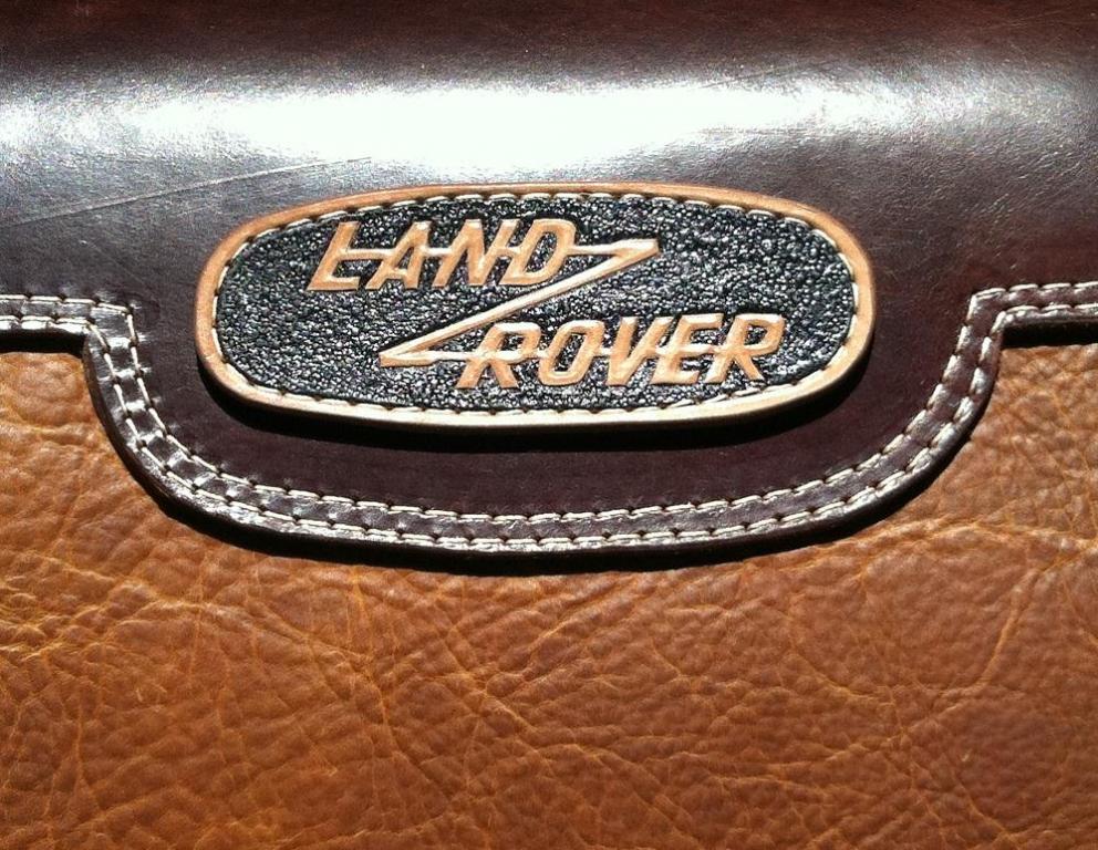

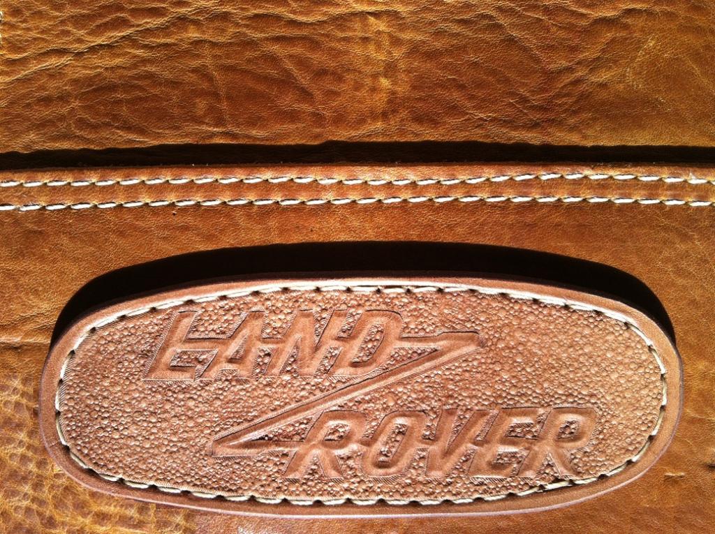

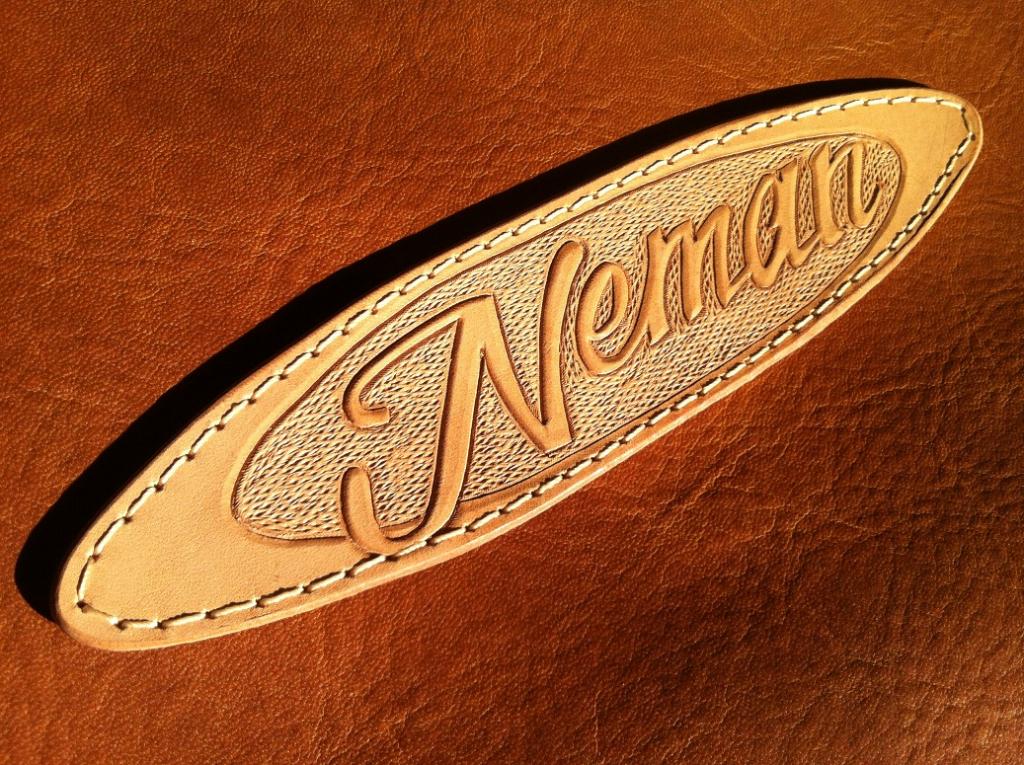

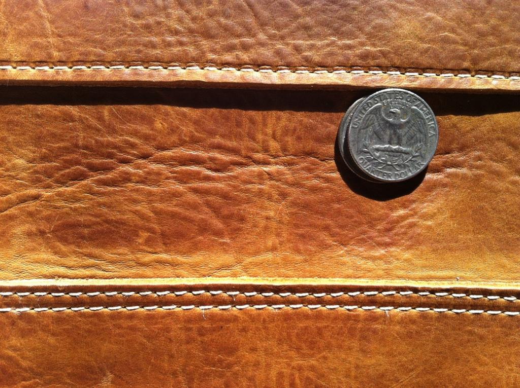

With thick leather sewing I needed to use a heavy duty upholstery sewing machine so I purchased a used Singer walking foot tripple feed machine and installed a slow speed low geared servo motor that can easily handle sewing this thickness leather and up to almost 3/8 thick. Most auto leather upholstery makers use size 69 thread, i'll be using larger size 138 to 207 bonded thread with a proper leather needle in size 22 or 23 that can handle this size thread. I've practiced on a few scrap pieces with size 138 thread and have the tension worked out on the old Singer and it looks good so far. I'll post a few pics of my sample sewing on the bullhide. It will be a while till I come up with a decent pattern for the saddle seat covers. Hoping someone else has done this before as I don't want to ruin an entire hide. Might have to make a mock up seat cover out of heavy canvas first.
